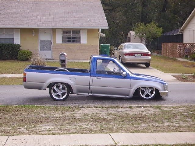

well my truck is all re bagged and the bag brackets are moved. the old set up the bag was full compressed and holding the frame up from laying on the ground so i moved the upper bag bracket to the top of the notch(step notch)
and now it lays frame hard but i dont seem to get much lift. what can i do? its a 92 yota and i have 2600's in the rear. i should get more lift with thsoe than 2500's right?the bag mounts have the port and bolt holes for the 2600 bags. so thats why i got new ones.
how can i get more lift? im nto doing a cantilever,
i have suicidedoors bottom bag brackets but if i use them then ill have the same problem of the bag bein fully compressed and the frame wont lay.
what to do what to do? suggestions?

measure it and make the brackets correctly. when on ground bag compressed

i wouldnt do a canti id do a machanical advantage lever i believe suicide doors sells a kit for that but seriously if it was at the bottom of the notch and didnt lay out and when you moved it to the top of the notch it layd hard but didnt get enough lift put it in the middle of the notch but you got to realize with bags over the axle you'll only get as much lift as the bag will go fully extended

heres an example of the lift from mechanical leverage,bags on bars 2600s its not fully lifted in this pic it gets about an inch more

i measured 8 times. i had no choice tog et the frame down cpet to put the top bag brackets at the top of the notch.
what im gona do is if need add another plate under bag on top of the plate thats there. thats no problem but i may get 1/4 to 1/2 more lift if that? ill dont knwo ill work on it today and post some pics tonite.
