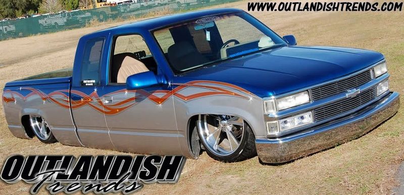

here is mine on 22's notched and arms

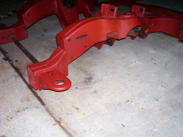

I'm wit dave on this one...Pie cuttin the frame works well actuallyThrow up pics of progress when you can

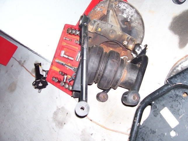

now that i have the arms on, i can see where im still gonna hav to take some out of the frame at the rear mount cuz it hits pretty good. BUT,, should i cut the bag buckets down and use them on these arms? cuz layd out the bags arnt fully compressed??? and i get the lift @ 150 psi that i used to get at 100psi.. and i dont hav the 22's on yet

get a taller top cup, and you'll most likely have to cut mount closest to the front.
