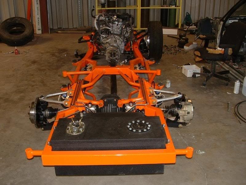

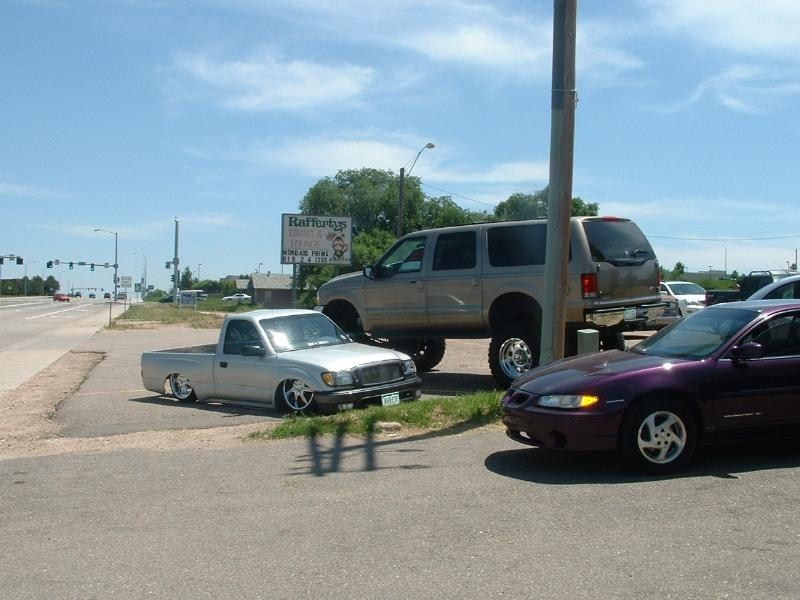

2lowtoy
this is my buddies truck its stock floored and no z'ed
impulse's avatar
impulse
that wild frame is under that tame taco?
