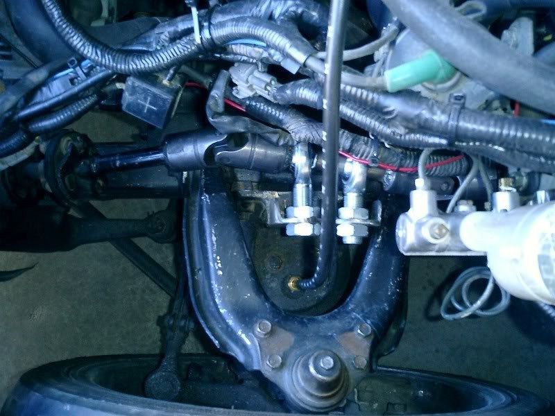

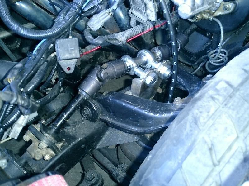

built mine out of tubing , 2 u-joints and a heim joint to make it with a custom made bracket that bolts to the back side of the control arm..... heres some pics...

heres mine. works great.
JasonW
framescr8pintoy's avatar
framescr8pintoy
i also have a 3.5" bodydrop with a 1.5 z'd frame

Jason thats what I need to do! Thanks for those picks. Hopefully mine will be close. I moved my arms up an inch, and I'm going to body drop 1.75" (to the rocker). Hopefully mine is close. Those weld on steering joints work pretty good?
kyle just wants to show off the chrome haha.. lookin good man, blinding
