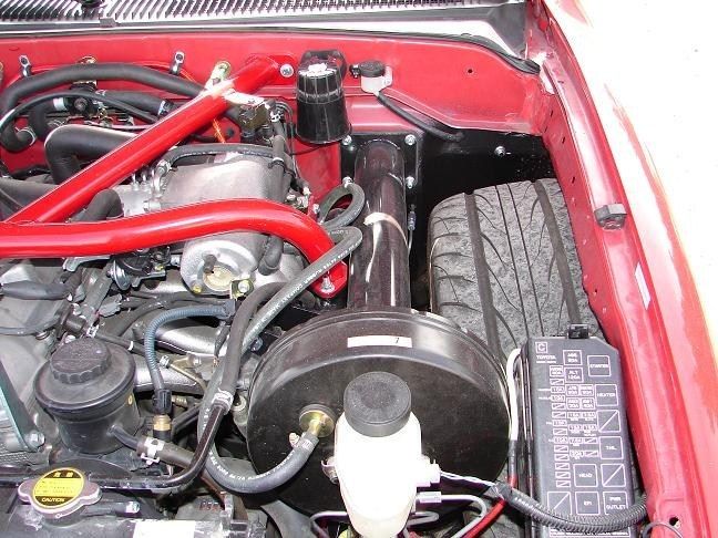

GFreeman's avatar
GFreeman
heres how i 1st did mine on my taco, but its gonna look different now cause im shaving the firewall.
framescr8pintoy's avatar
framescr8pintoy
2 of the 4 holes mounted up.. needed to make a new plate to mount it too then also make the linkage hook up and then i had someone help with the correct plunger depth.

olskoolpup
damn, that booster is way up there. like a 720 style, but on crack!! damn good idea though. you never cease to amaze me with your ideas!
olskoolpup
oh yea, the clutch master is pretty bitching too!
