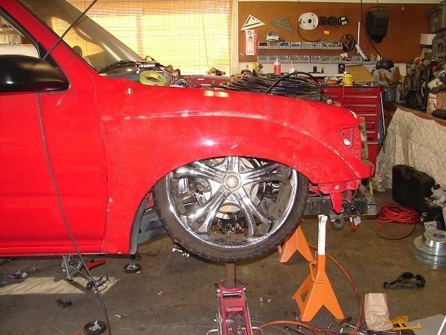

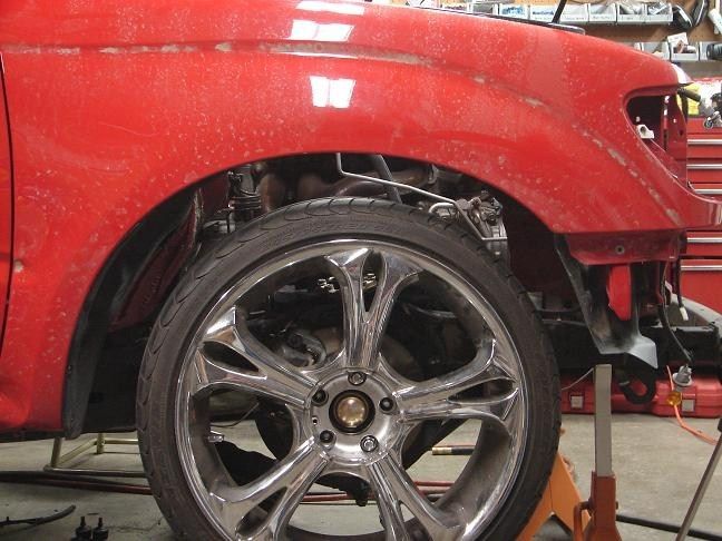

ill post some pics when i get home of lift with a 20 inch wheel 4+ inches past fender
HotRodDime's avatar
HotRodDime
^^^ no way that's not possible!
