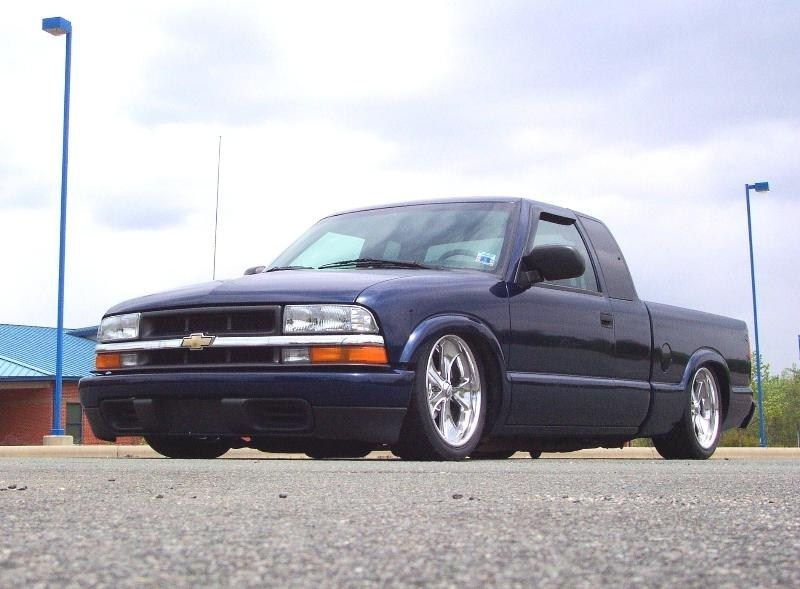

This is how close......

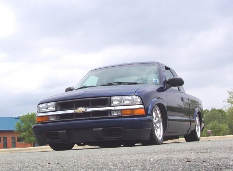

That pick is w/o the frame notched, it just has the bumpstops takin out here is mine with no c-notch and the carrier bearing is touchin the ground

from everything i measured you should be able to lay with 2.5in notch from suicidedoors with a 25.5in tall tire

Http://www.streetsourcemag.com/Profile.aspx?ProfileID=28809
this guy has the airbar and the notch from suicidedoors...
AVTekk's avatar
AVTekk
you will def not lay with those tires and any size notch with the AirBar. the biggest problem once its notched is the driveshaft will hit the clamshell bracket on the gas tank crossmember, and theres nothing you can do about that but start welding stuff. also those tires are 1-1.5" too tall to lay out without cutting the wheel wells open..
