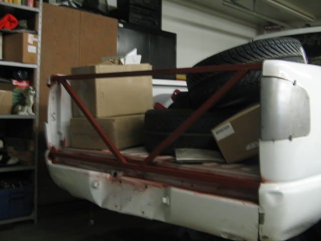

u need to weld some framework between the boxsides to keep them from flexing and cracking the skin. The design will depnd on what kind of truck. This is my buddies 2nd gen s10. Just 1x1 tube.

on my green bitch i welded a peice of angle iron(like 16ga)where the bed floor was and then tacked to themiddle of the skin,and have a peice of 1x1 square tube at the top... had it on for 4+ years and havent had any cracking problems cept where i have cought the bottom on something dragging and fucked that part up.
