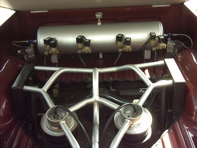

how was it that you did that setup,didn't it kink any of you tubing,what kind of tubing did you use,what kind of bag cups did you use,man i admire your work seen alot of it,first time i seen it was on the ranger that the setup was painted green,that was pretty wicked
DodgeRT's avatar
DodgeRT
heres another angle of that pic i got at Layed out at the park

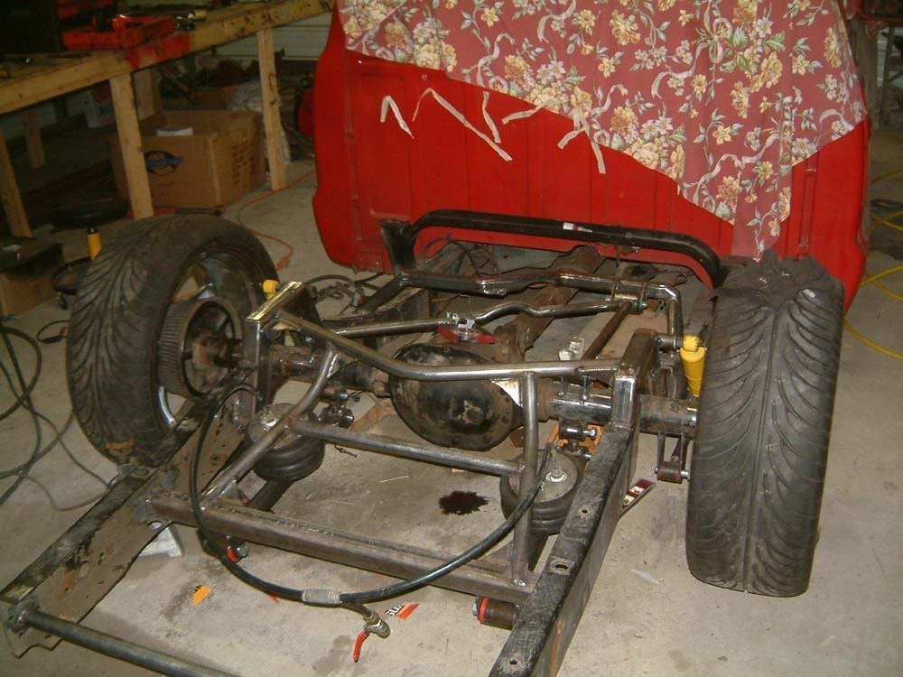

I used that style bender for this set-up. 1.25" 1/8 wall DOM. It works OK for minor bends. I capped the ends and filled the tubing with sand on all the pieces as well.
mindlissmetalfab's avatar
mindlissmetalfab
forgot the pic:
AVTekk's avatar
AVTekk
the problem is that bender is a pipe bender, tubing and pipe have different OD tolerances. so when you put a piece of tubing in there, its sloppy which causes the sides to move outwards and the tubing will flatten. if you have a heavy wall, ya it should work for small bends, but with the price of DOM these days, 1/4" wall is a hell of a price to pay..
