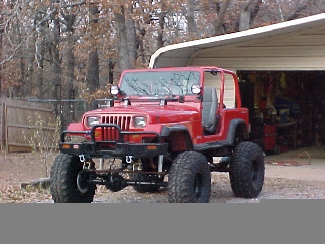

this is sprung over you can get the perches at a 4x4 shop make sure you flip the centering pin on the leaf spring over to and set your pinion angle then weld the perches in you will need longer u bolts and brake lines and to do it right you really need to do a high steer kit in the front so the steering dont bind up when you turn check out pirate4x4.com for more info hope this helps you will also need to modify your transfer case with slip yoke elimator because of the pinion angle..
