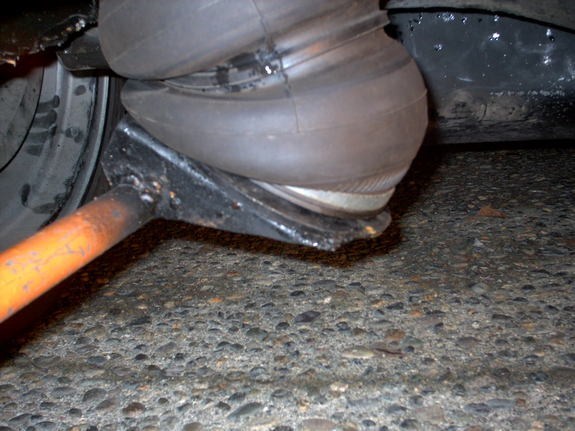

My bags are mounted on my bottom bars but my bars arnt dirrectly under the bags, there off to the side.. well i also have heim joints witch when i air up they swist and the bag sits weird.. so i tried to fix the problem by putting one bushing end on each end of the bars for a quick fix.. but now that didn't fix it the bar is still turning on the threads of the bars and making the bag sit.. anyone have any problems like this? or do i just need to move my bottom bars in so that they r directly under the bag and not to the side?

Definitely center the bag/bracket over the bar. Don't want the bag sitting weird like that, plus it'd be hell on the bushings. Got any pics?

This is all the way down but i now notice that the swisting has gotten worse.. so im goin to buy 2 new square none adjustable bars with bushing and get them in the center of those bags cuz that ant workin. would that do the trick?heres a pic i dunno how to post it but ill try...

You should make sure your 4 link brackets arnt twisted or tearing away either. You might have to replace them.
Those bars are pritty small for you to place bags on.. You can strengthen it by running gussets length wise on the bottom of the link bars.

when i air up all the way it all straightens out..

thats not good thats bad, that means the bags are full and WANT to stretch to one side more, but are limited by the bag material.
Dont use heims, dont offset the bag on the bar, and use stronger bars, and you will fix the problem.

Do u think it would be worth it just to move the bags over the axle? or should i keep the bag where it is and get suicidedoors Square none adj. poly bushing 4link bars? there 2"x 2"? would that be stronge enough

Those are just fine. Just center the bag on the bar when you do it the second time.
