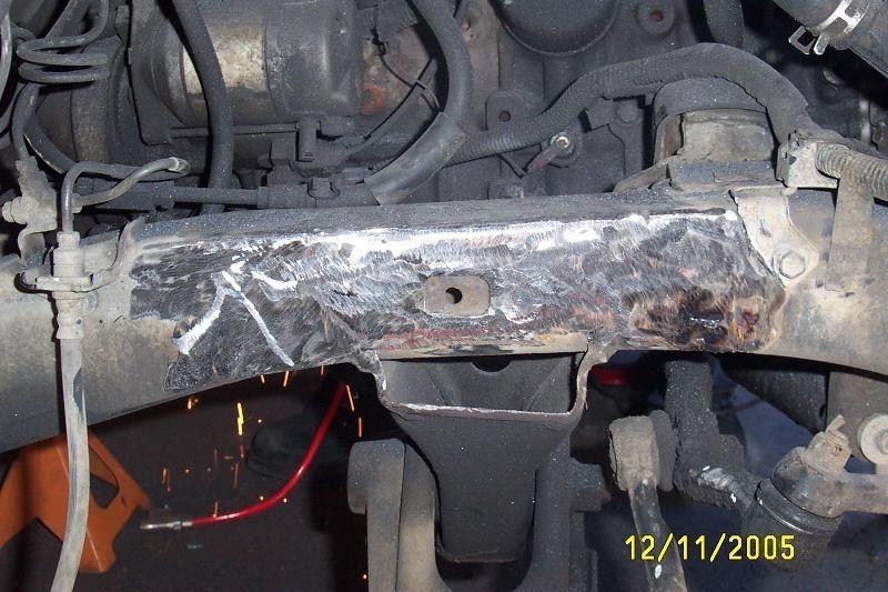

ok right now when i jack up my lower control arm when it hits the bump stop its layed so my question is after i cut out this bump stop how much higher will the arm travel. I just want to know so that i dont crush the bag of drag strait through the frame. or if the lower arm comes up much further would it be better to set it up so i can do negatives.

Im a little confused on the draggin thru the frame/crushing bag/negatives part.. let me know what ya meant. What is usually done, is cut all that bumpstop stuff outta the way, plate the rectangle shaped hole to stregthen it back up. then youll wanna jack the lower arm up as high as itll go and work from there. find the right spacing away from the framerail, then tack the lower circle plate to the lower arm. bolt the bag to it, jack the lower arm back up to that maxed out point and compress the bag with your hand to see where the upper bracket will line up at. the upper and lower brackets should be parallel to each other when laid out. tack the upper, remove the bag, weld it all up with gussets, etc.

best thing to do is just cut everything off, rickys site has some good pics like he said. i did my gussets diffrently then he did, but its all the same idea. then just jack the control arm up till it wont go any more, then you work from there, its pretty simple. i have my 87 bagged on 195 70 r14's and lay crossmember. so if you ever plan on gettin bigger wheels, set you suspension up for them now, thatway you wont have to hack your brackets off and move them up later down the road

Yea definitely dont wanna screw with having to cut them off and redo them later.. that'd suck. Don't worry about laying "too hard" to where you can drag alot of the crossmember off, it's not gonna hurt anything unless you actually DO drag completely through the frame and hit the oilpain, etc lol.
