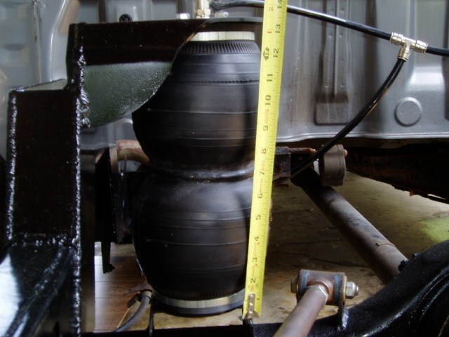

i would say go with the universal. maybe not the 13" maybe the 10" placed a little further inboard
TD
the dirty 10
the rs slams changed to re if im not mistaken
U
UNIVERSALAIRSUSPENSI
The reason you can not run them in the front is inorder to get that extra lift out of the bags we have designed the inside fabric to cause the bag to streach straight up and the bags will bellow out the side if your put to sharp of an angle onto them (i.e. Front Suspension)
bagmazdog
i have them on mine also i get just over 13"s.
