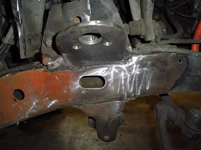

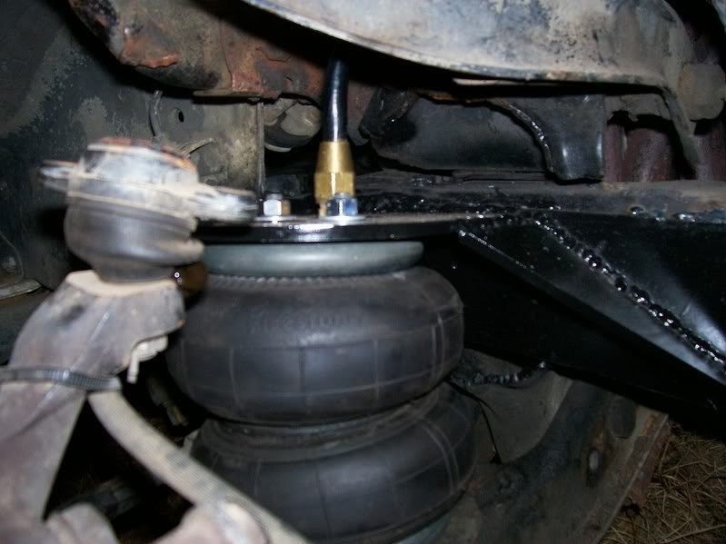

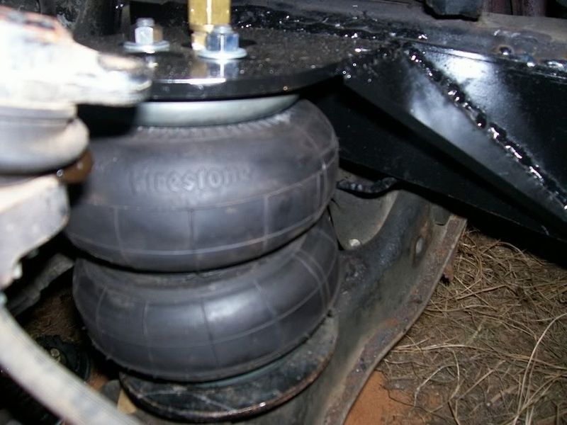

heres the best pic tha ti have of the front set-up with shocks
PD
Piecessan dragger
good god thats a massive bag for the front.
sadisticiron's avatar
sadisticiron
rs62 but it does look big in the pic

Originally posted by sadisticiron
heres the best pic tha ti have of the front set-up with shocksWould you happen to have this pic but without the bag installed? So i can see how the upper mount is done? And does the a-arm hit the mount??
sadisticiron
the upper a-arm goes around the mount without hitting the lift it gets isstock height

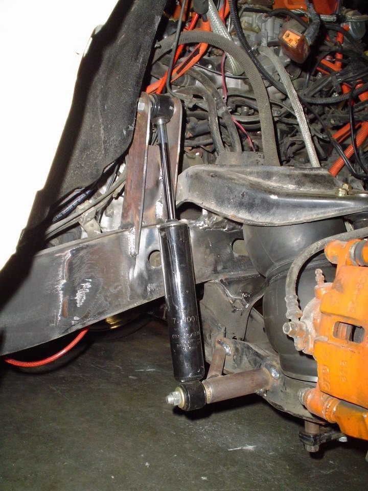

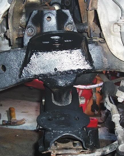

Hey, i've got a got a pic of my front setup in my profile, its a little different then most i've seen cause i ran some extra supports down the sides of the upper bracket, so it doesn't tear away from the frame, or bend upwards.
wht01ranger's avatar
wht01ranger
mine is like his ^^ top and bottom gussets
sadisticiron
Edited: 12/1/2005 8:53:51 AM by sadisticiron
yeah that mazda has upper gussets the photo was taken before the gussets where installedsorry thats the only 2 pics that i have
