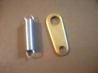

ok now i'm having trouble finding where to put the throttle return spring and the little metal bracket that it comes with see pic below, if you have any pics of your carb that shows this please post them or e-mail me at brandon005@comcast.net thanks
drpdmazda
i ended up just re using the factory return spring and threw the one that came with it in the garbage and it works fine
W
wormy94
There is a bolt just below the carb on the back side the bracket goes there spring from the bracket to the carb It doesnt work very well thow mine fell off twice now im not using anything works just fine

i got it worked out and I must say i love the weber for anyone that doesn't have one you should get one its the best $400 I've spent so far
