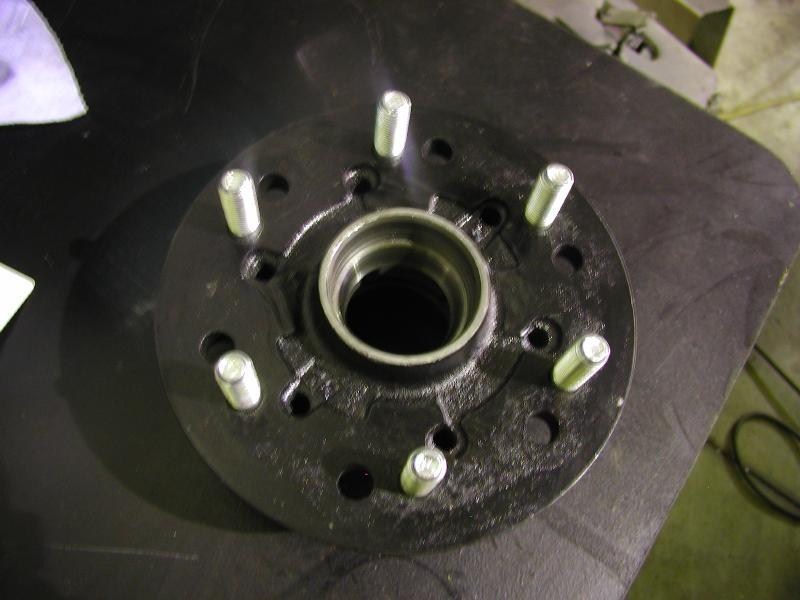

ok DONT take this the wrong way, im not buyin navis i wanna know how far exactly your wheel studs were off, cause my rims i bought the other day looked like 6x5.5 but arent cause the studs are all a little off im thinking less than a 1/4" each were yours the same way

Yeah they are off I know that for sure but I can remember the lug patterns. If you where putting them on you could either just bolt them up and hope they don't back off or there are special lug nuts that have a seat which slides free from the nut that will bolt them right on.

the navis are off about that much. I had em on mine, but didn't like em..

Navis are 6 on 135 mmMazdas are 6 on 5.5 in or 6 or 6 on 139.7 mm
So basically, the Navi pattern is 4.7 mm smaller than a Mazda. I redrilled my hubs for my Navis, so they're perfect.
