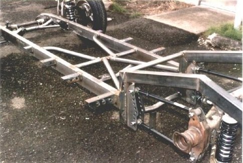

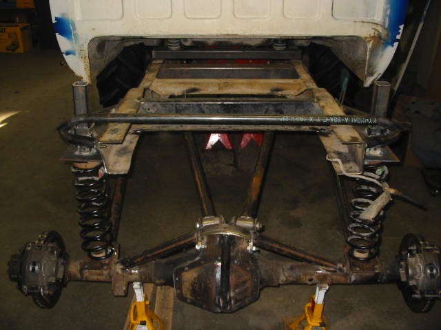

Edited: 10/14/2005 2:38:32 AM by NO1LOWR
these should help man, they are kind of subtle but you know what to look for. and where the hell are those cnc signs that you were gonna make me bro? let me know, good luck with the ranger.
