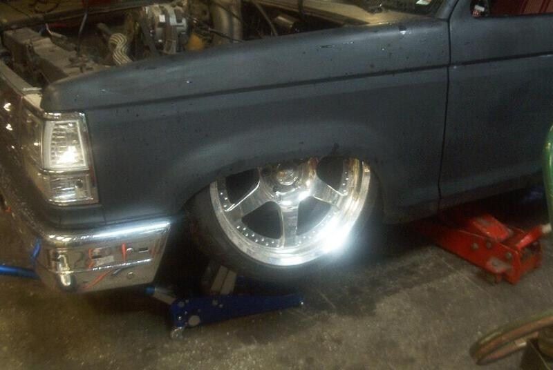

The front end is pretty much done, besides the relocation of wiring and computer all the welding should be finished. iLLblazer will post a picture sooner or later.

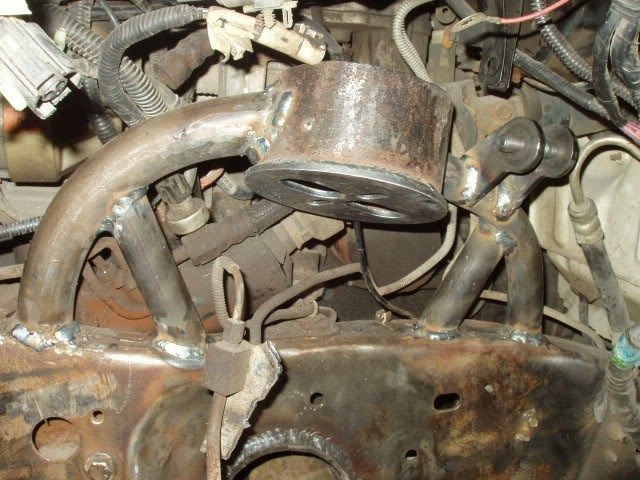

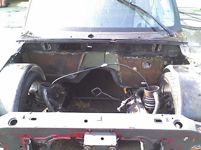

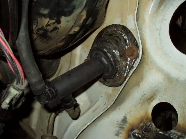

Just a bit of an update. All the fab work is pretty much done on the truck:Front Drivers Side:Passenger Side..got tie rod notches?:I modded the clutch cylinder so the line doesnt dump into the tire anymore. Rear setup..newest pic I have. Its all doen with shocks and shit now thoughJust finishing up the new crossmember I built to replace the one right under the back of the cab, then the fab work is done and its time for body and paint.
