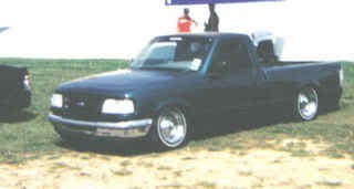

I agree with everyone who posted previously. I had a 97, I got a west coast customs front kit and they f'n sent me over the axle REAR kit!!! ended up making a kit, then had Kurt from Autocore in PHX redo it again, he mounted 2600's on the radius arms after bracing the shit out of em with 1/4", it rode real smooth. he also notched the frame in the front in 3 or 4 places and rebuilt the factory skidplate thing, it already had the xmembers on it from my 1st suspension incarnation. it went through tires and pulled HARD right when you dropped to drag cause of unequal length Ibeams, do yourself a favor and spend less money and have a reputable shop weld a toy front clip on
poontang2005
also the frame rail profiles in the rear aren't exactly the same, it makes it a little difficult to notch, back halve it too, lol what do you have left?? nothing if you want a stock floor bd, have a real good plan laid out or just spend 4g's+ in suspension like i did and then some punk asses steal it and wreck it
poontang2005
http://www.streetsourcemag.com/issues2/viewPhoto.aspx?Type=Magazine+Show+Coverage&Photo=/uploads/Ownerprofiles/poontang/markranger1.jpg&Thumbnail=/uploads/Ownerprofiles/poontang/markranger1_tn.jpg
