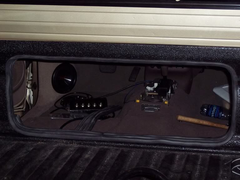

sandog
go to the camper store and get an accordian boot to seal it. That way it will flex between the cab and bed and seal it from water. http://img.photobucket.com/albums/v103/Sandog/100_1076.jpg
