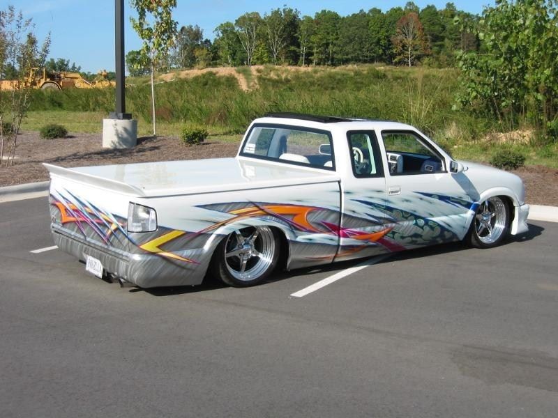

I was wondering if anyone could explain to me, or show me somewhere with an explination, of how they did a Chop Top with stock glass?

they lean the pillar back to keep the stock front window. the back window they jsut take the cut out lower the bed i believe. side windows i dont believe are stock glass. took phil a while to build that truck and its owned by Kim...sickassride.....

GOING BY the pics im guessin they laid the window back cut a section of the back wall out and dropped the rear window..they cut slits in the window surroundign so it could drop down into a pocket so to say and the door window is stock..hell i could be wrong but thats whut the pics look like

They tucked the xcab windows down in the cab so they dont open. I dont know how they sealed it off though?

i am corrected. the side windows are stock. like he said^^^ here is the link to the build.... http://ifcustom.com/projects/projectspages/k-m/kimberly.htm

thsi truck has also been chopped using ALL stock glass.

On the September 05 issue of Street Trucks IF Customs did a chop top on a fullsize truck & used all the stock glass! They show it all step by step! Dont know if this will help!

ok, Let me rephrase, I understand how they kept the glass on the 3rd doors and rear, I also know how they kept the windshield stock, I just dont know how they kept Both the windshield, and the side windows. I dont suppose anyone could post that article from street trucks could they?
