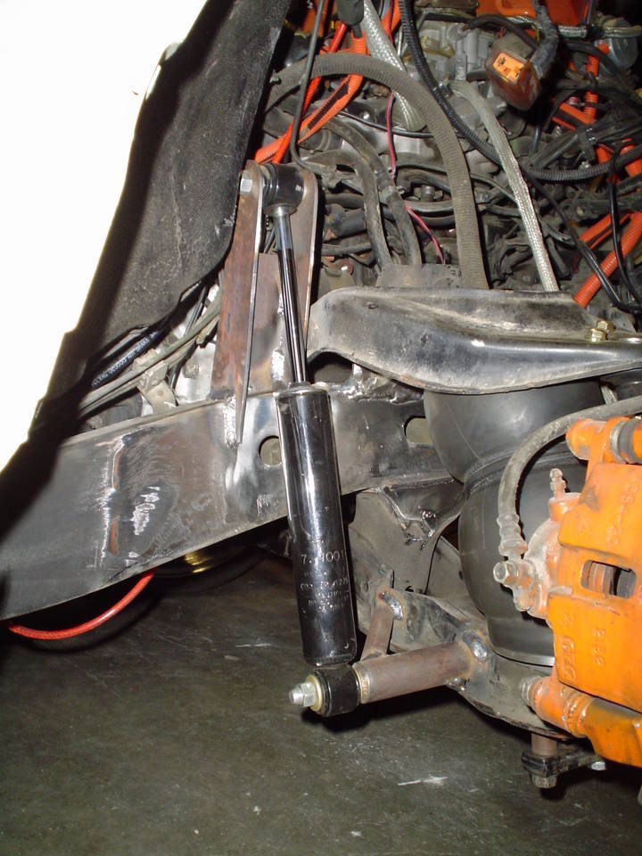

I put mine off the back of the LCA to a mount off the frame. Slight angle on both axis (from straight up and down) to clear a turning tire.

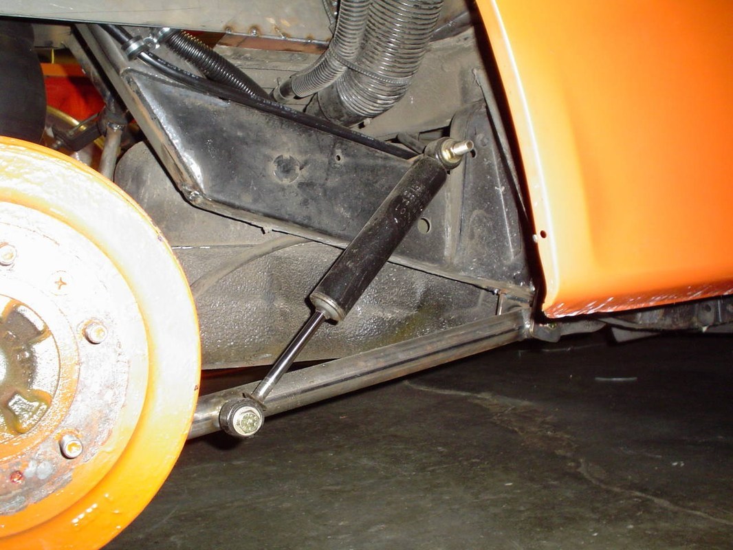

I plan to run my shocks on the bars. I know about the compound forces, but they are heavy duty gas charged shocks and I doubt I will ever exceed their ratings with a piddly little mini truck.

heres some pics of a truck in the works shocks up front and rear on the bars. having shocks depends on u and your ride preference i install shock and all trucks that way when if the customer doesnt want shock cuz of ride he can take them off but all the trucks i have done ride better then stock with the set up and way that i install them
