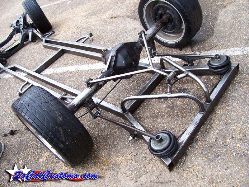

can someone explain how this works?

Ummmm, you inflate the bags and it lifts the frame. See the pivots on the rear links infront of the bags?

cantilever?
Fazethree6661's avatar
Fazethree6661
never seen a frame under the axle though that is my thing.. I mean i guess it would make it easier to drag frame though. just trying to figure out why the axle is over the frame.thanks for posting that too

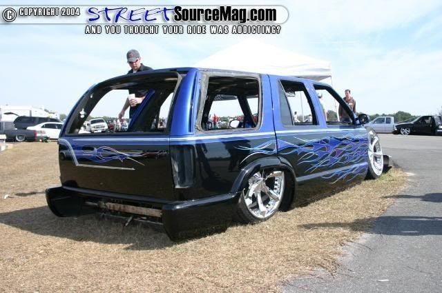

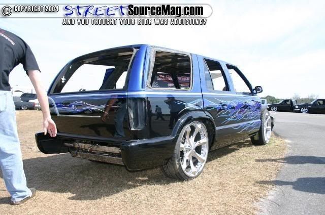

the frame goes under a durango, the guys SSM screen name is "lowrango", just ask him, sure he can explain it
Fazethree6661
cool thanx its just confusing.. I am still kind of a NEwby in a way. but never seen that before
impounded dakota's avatar
impounded dakota
one probably to be different, two to gain more room inside the durango, now that 4" of frame rail are no longer in the way.

there's a couple guys with the frame under the axle out there now.
AVTekk's avatar
AVTekk

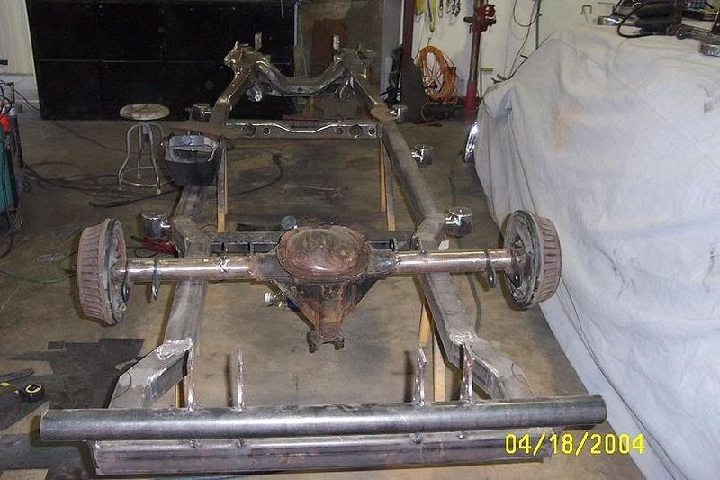

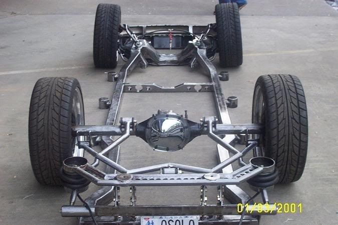

its done to keep the frame out of the interior. of course your lift is limited because the frame is in the way but the taller wheel you run, the more lift you can get. heres another one thats been done for awhile..
btw 50/50 links
