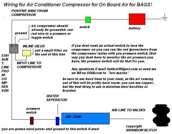

all you need is an inline oiler and water seperator then a check valve in your tank hook the pressure switch to the hot on the compresser you good to go i converted my dodge ram comp. over its a sanden works like hell tell you buddy he is full of it
