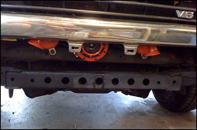

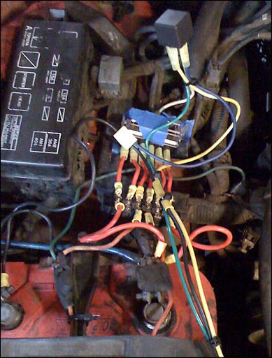

Horns and rough wiring:
The buss bar, fuse holder and a relay holder will all be mounted on a piece of phenolic, which will be mounted on lengths of threaded rod to hold it above the fender and the factory wire runs, but low enough to be below the level of the main fuse box. Relay holder will have relays for horns, headlights, front fog lights. Rear fog lights only draw as much as brake lights so need for a relay.
