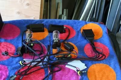

Here's the DDM HID kit I recently installed

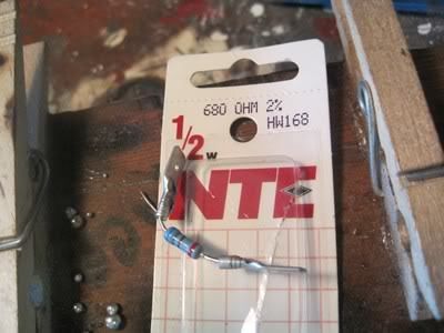

It seems you need to install a diode into the open plug( the one not used)
and this is what I used
This allows the high beam indicator to work!

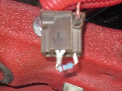

It installs into the low beam & ground pins on the unused stock plug

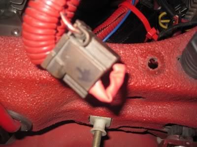

I also covered it with shrink wrap

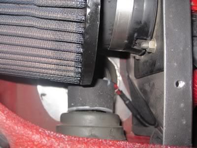

The bulb is longer than the stock bulb & I made a shield out the radiator hose for both sides!'The drivers side sits inside my air box & the filter can rub on it!
