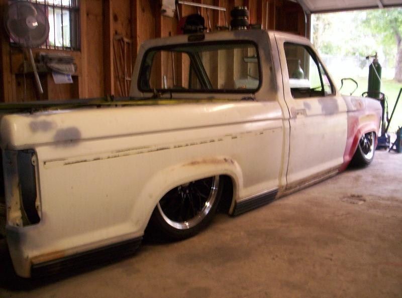

rockboy
i had a parallel with a panhard, but it wouldnot lay on 20" with ac, so i sold that bitch. and built one that would HAHAHA just jokin i love rangers layed out i just wanted a bigger truck
rockboy
re building right now
Tucks nice!
