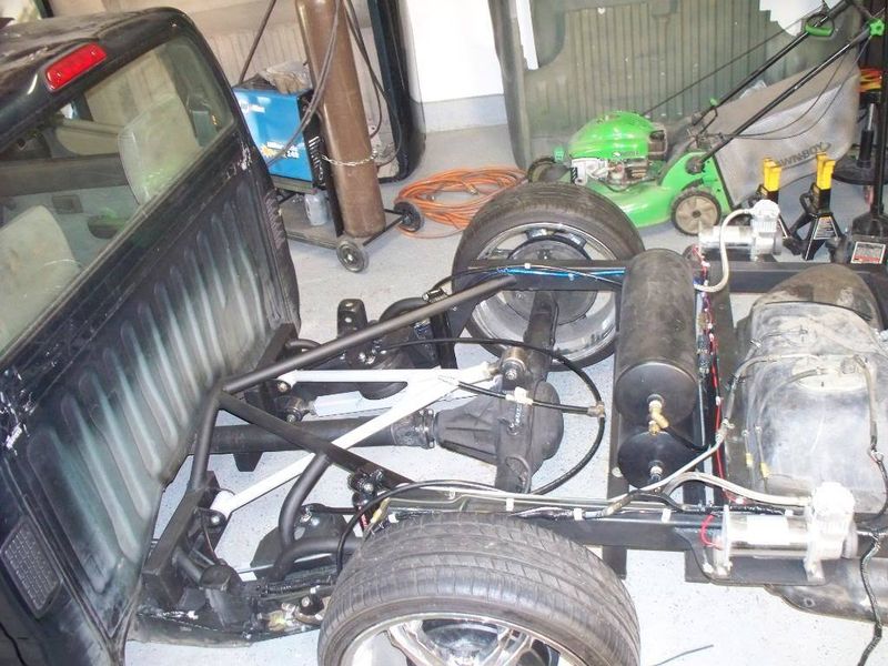

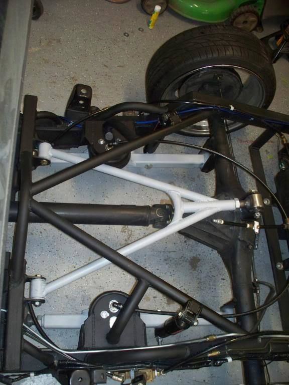

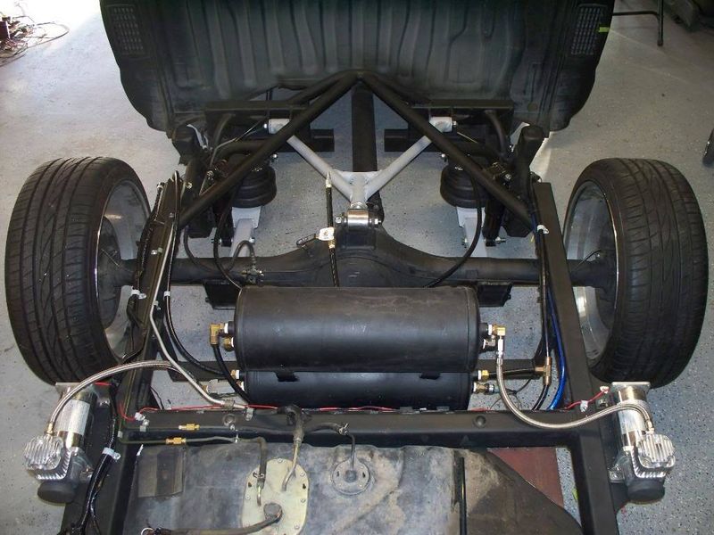

Got the backhalf all fabbed, just waitin' on some airline and like two fittings from suicide and I'm in business!!
Man that came out awesome! Nice work man I bet it rides really nice too
stll2hi's avatar
stll2hi
My fault, I meant to put this in my buildup. I can't wait to get it on the road, hopefully suicide comes through quick!! Thanks!
