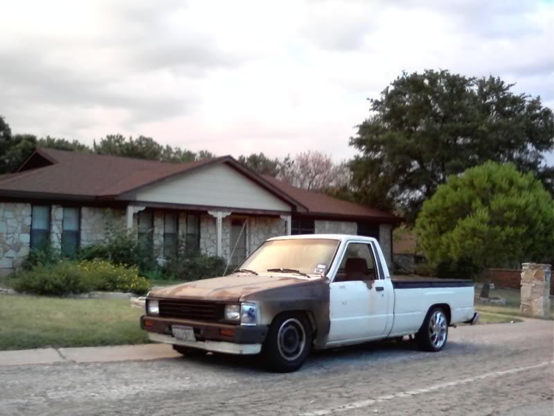

the bolt facing the ground needs to turn counter clockwise. You need something to hold the bolt up top still. I think its a 15/16 or a 7/8 cant remember for sure. anyways the easest thing to do is throw you truck on some jack stands and have at it. You have to turn it quite a bit to get an inch of travel. I measured the center of the curve of my wheel well to the ground to figure my height. Also you are going to want to drive it for a few days and remeasure. When the suspension settles it will go lower. Here is a pic of my truck with only the torsions turned and the bumps out. I have very very little camber. Rides rough but fack it!

here is mine cranked down with stock wheels:
