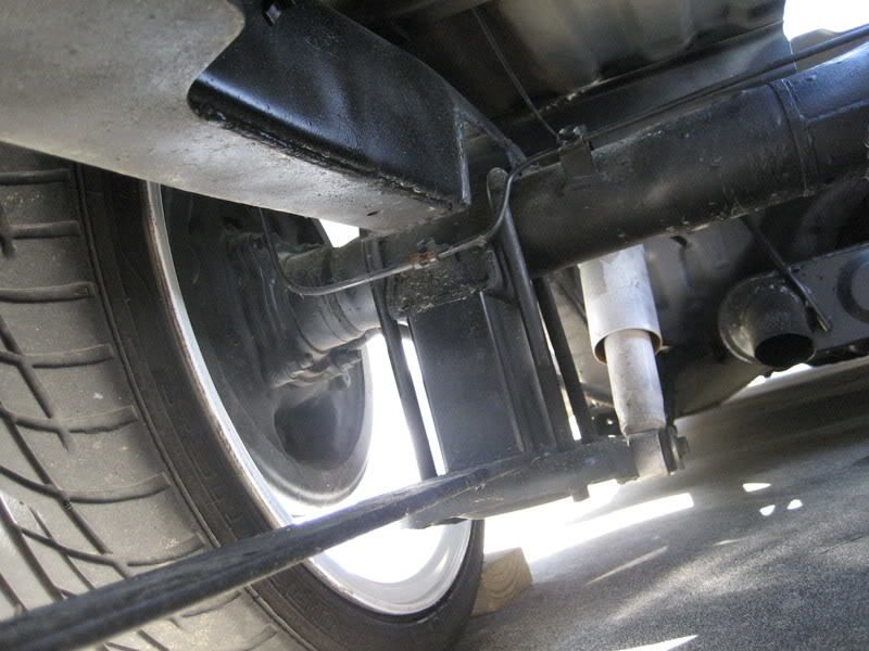

Ok...Ill try to help you out bro. All lowering blocks are/should be universal & the bottom of the block has a hole it in that fits over/on the bolt that runs through the leaf springs. The top of the block has a nipple the fits into the hole on the bottom of the axle-the leaf spring mounts. Here is a lame pic of my truck...its mono-leafed with 4-inch angled blocks. If this doesnt help then let me know & Ill try to talk you through it some more!

See that's what I thought it should have been but the block that I have the bottom of it doesn't fit over the that hole on the leaf spring which I thought was weird. It does sit on top of it but I was worried about it shifting that way while driving? That would blow!
That pic really helped I was on the right path looks like.

Yes you can take that bracket off...Id do this if I were you. The truck should have 3 leaf springs. Unbolt the springs & take out the center leaf & just run the main & the overload spring-that's the short fat one. Then take your block & place it just like Ive dont in the pic. make sure that the u-bolts are tight & everything should be ok. oh & like I said earlier...make sure that
the hole in the bottom of the block sits on the bolt in the center of the leaf
springs & the nipple of the top of the block sits in the hole on bottom of the axle/leaf spring bracket.

I wish you could/would post a pic of the bottom of the blocks you are using so I could see if the hole that is suppose to keep the block in place is not broken. I had a block once break at the bottom & cause the rear to move. Im going to post a pic of a set of blocks that ive got just to make sure they are what you have. I want to make sure you get this done & it be safe!
