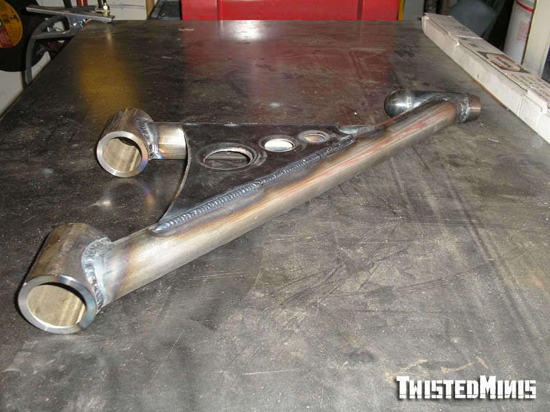

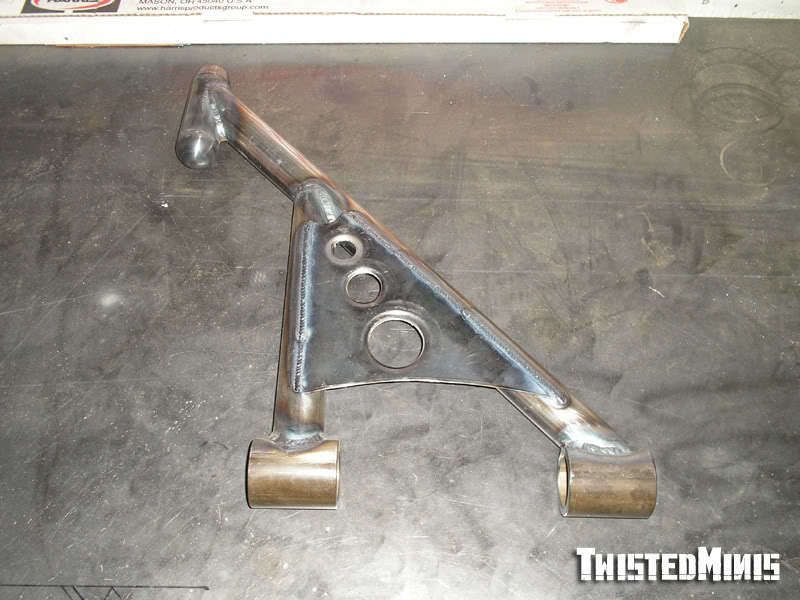

Also heres a Toyota 3-link I just finished up. Improved on my original design for a production kit.
Its offset so the front can be mounted lower and keep good link geometry and not be influenced by the drive shaft.
m_i_zombie
Actually those are the bars that the bags ride on. His lowers go forward like the upper. You don't want a 50/50 set up, thats asking for trouble.
