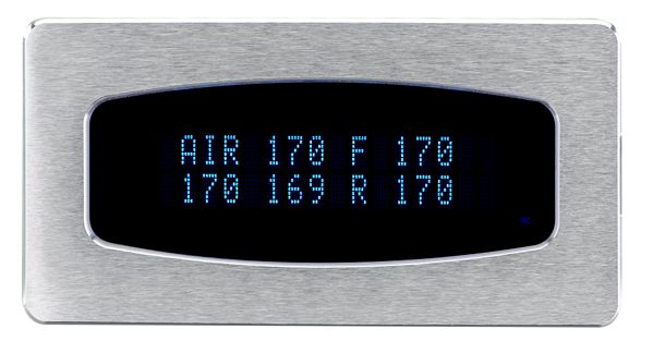

another option on the gauge situation is Dakota Digital.
