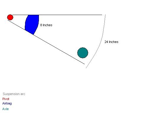

Does this help?

ahhh... so my lowers are 32" long.. should i put them somewhat towards the middle of the bar? or closer to the cab...

that pic makes alot of scense (lightbulb clicks on)
i just dont want to pop my bags by having too much force on them... u knwo wut i mean?

Yeah. Do you want a lot of lift or just the ride quality? Mine are closer to the axle than the pivot, and it makes for a really nice ride. Its just right to me. On the Mazda I noticed it was softer, and smaller bumps felt bigger because it was such a large ratio.

i want lift, and ride.... if i can get it so i can change a tire without having to take the bed off that would be great, and i want it to ride nice, and not all bumpy like driving on bump stops...

Mine untucks the tire. If you have 36" bars, I would put the bag about 12-14 inches away from the axle. Your bodystyle tucks a little hard in the back than mine. And mine is mount 9 inches away from the axle on 20 " bars.

i got 32 inch bars... ill try the 12-14 inches... ill do 14 inches first, and see how the lift is...
