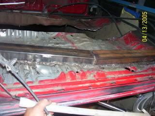

But back on topic for a second as far as how hard is channeling the cab it self i dont see it being much harder (cutting wise) than a trad.B/d
so far i think mines cool.

ALL YOUR X-MEMBERS SHOULD BE ATTENDED TO PRIOR TO ANY THING!!
take off all the body panels(fenders, grill, hood,bumper, ect.)cut the front of the frame off bout 3 inches or so before the radd support (Boom..out-a-there!!), then Z the frame in front of the firewall so you can lay flat first.(dont do what i did, BD first).
Flat? good!
But the front ends to high now ,so BD the cab now.
Cab flat? good!
Mock up where your inner skins used to line up.Now you will see that the frame attached to the truck (amount will depend)is higher than whats still attached to the rad support with all things lining up.Build some sopports so you can tack the 2 pc's together.
Then fully box(wrapp) it up.
FLAT ? HELL YEA!!!
