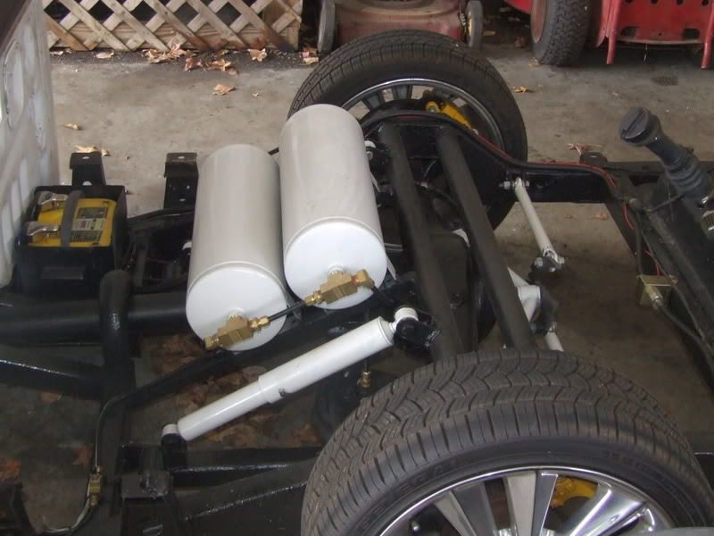

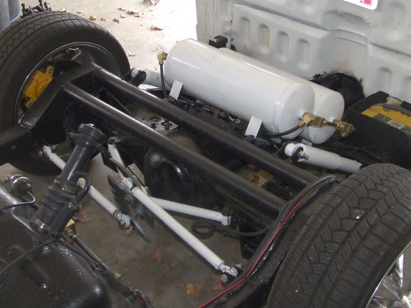

You should have tried to talk him into a link setup like I built.
oldsklminitrk
Yeah mine is tucked up under a body dropped bed and doesnt really hang that low...
twisted minis's avatar
twisted minis
That looks good Roney, but those shocks arent doing shit for you. You might as well take them off.

The shock angle will get better as the truck lifts it looks like. Still not ideal but I'm sure its better then nothing. haha.
Anyways. yeah a Wishbone like yours would have been ideal. The customer has been buying parts over the last several years it seems (brought us manual valves and stuff too). The 4 link was on its way when he called to set up an install. It sucks because he paid $500 USD for that link setup plus shipping duty etc. hes probably into it for $700. For $200 US for 4 bars from SD, and another $100 CDN in brackets and tabs from me, he could have saved enough money to buy a fuel cell too and had a 4link built specifically to my measurements for his truck.
I'm not hating on the cando link, its all quality parts. But I had to make it work as a forward setup which meant changing a few tabs, and modifying some of the brackets it came with and the bar lengths arent as ideal as I'd like them to be. Could have all been avoided, and had a nice fuel cell, all for the same amount hes already spent.
