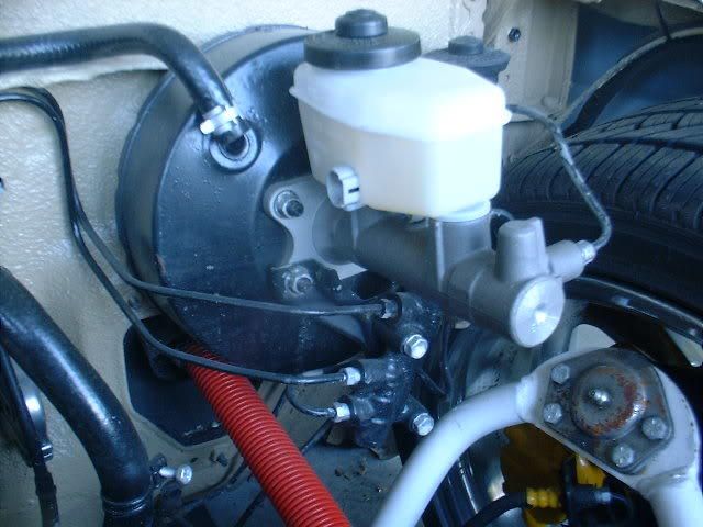

You can also get one off of a 84 toyota the porptioning valve mounts under the master cylinder and you can run a single line to the back and then split it with a t to either side.As a bonus the porptioning valve acts the same weather your lowered or not back its in a staionary postion

The 79-83 trucks also have those same proportioning valves under the MC.
RD
rubber ducky
my 05 scion xb has the same proportioning valve under the master cylinder. LOL. anyway, yea i like the valve under the master cylinder. makes the rear cleaner.

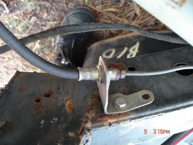

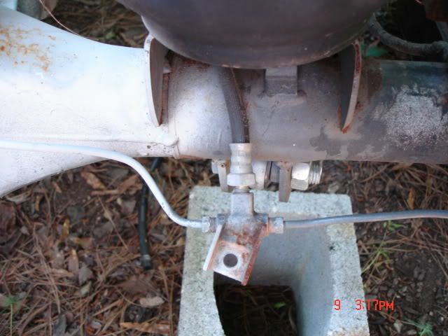

modifydtoy
here is a pic of what i done!
krayla
Can you explain what you did exactly with that modifyd?
