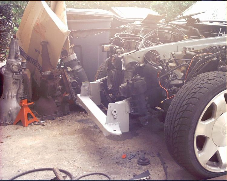

psycopathicryda
This is the closest thing I have for you on how I built mine on my nissan. I built a new cross member after trashing the stock one. I reused the bumper mounts and radiator mounts.
truck action's avatar
truck action
I believe that is stepping the core support,not Z'ing the frame.

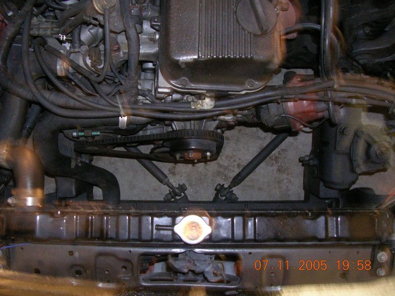

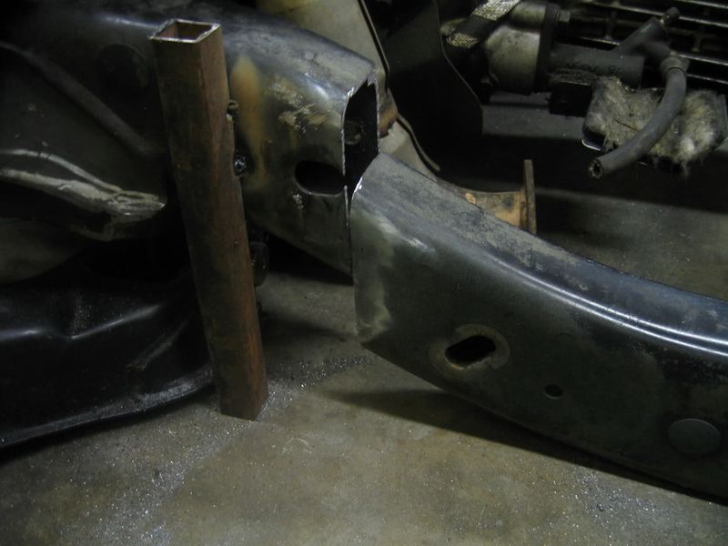

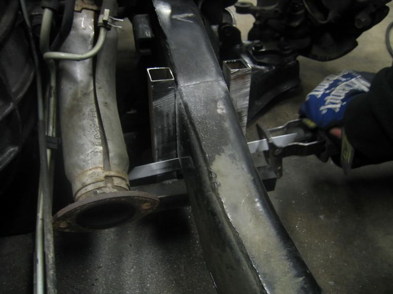

twisted minis
Sorry to bring up an old post, but I have some half decent pictures...
1.5" 'Z' is all you will need. It's actually 1 5/16" but 1.5" is a safe bet. You can actually get away with not 'Z'ing the frame. You can cut the bottom off of the crossmember, and rebuild it. Your front rails end up being about 1/4" off the ground right before the bend up. This is what I am going to do. Even thinking about moving both arms up about 1/2" or so, and dropping the motor 1/2" to 3/4" to keep the stock hood.

twisted minis's avatar
twisted minis
Well, my frame won't lay flat without modification. The front crossmember hangs down too far. And I plan on body dropping it 2 1/4". As of right now I have 1 3/4" hood clearance between the hood and the highest part of the motor (air filter). If I drop the motor down 1/2" or so, I'll have enough room for the body drop, and be able to keep the stock hood. Also plan on stuffing 18s under it. Not sure if my master cylinder will be in the way. I'll find out when I get there. Hoping all goes well and I don't have to relocate too much stuff...
