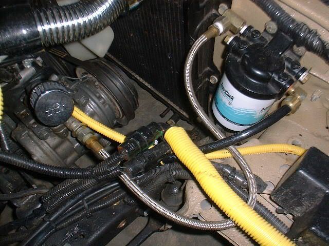

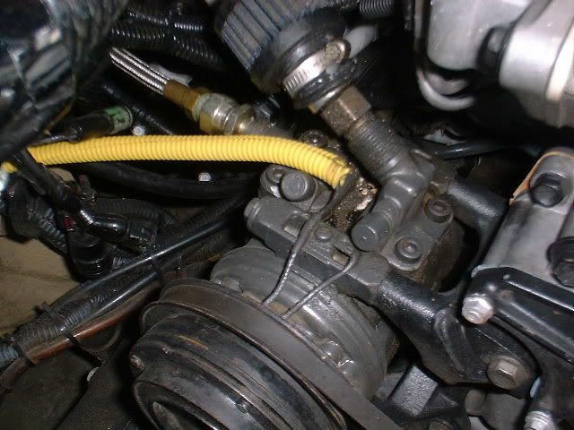

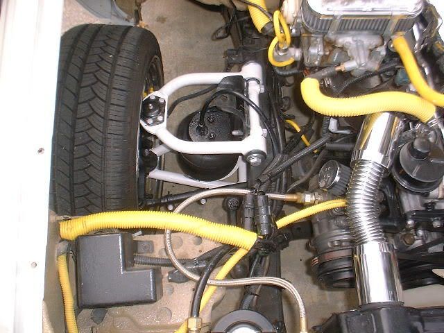

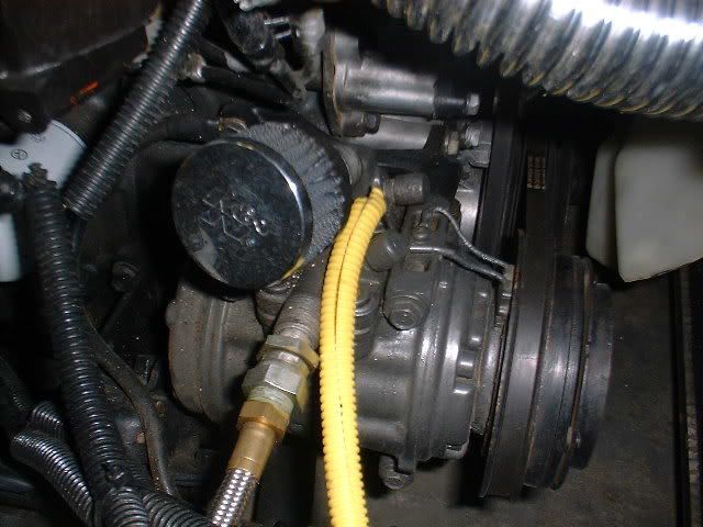

Ok yeah I forgot about this thread too.......whatcha do is remove all the a/c componets in your system.Then have someone tap out the top plates on the compressor itself,ya wanna do pipe thread.on the suction side your gonna do a air filter.on the discharge side your gonna do a steel braded line that runs from the compressor to a dryer.Then take the clutch hot wire and remote moutn it to a switch.
Here is a few pics to help ya out.
