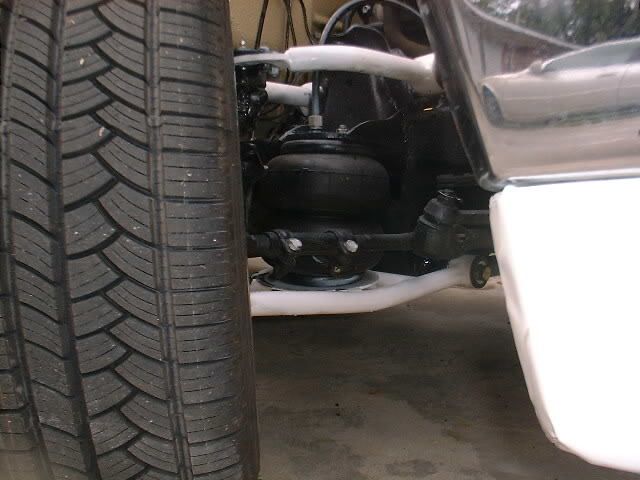

I dunno who told you they have broke cause I pound the snot out of mine and they aint broke yet
Ive had mine from Mike for a few months now and no problems....

I changed the balljoint plates from 3/16 thick to 1/4 thick back months ago.
