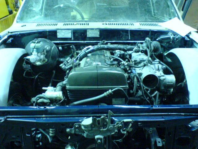

Mine are welded to the bottom of the pinch weld. Lol.
Theres the start of my inner fenders. Should be welded up tomorrow and have a few things attatched to them.
truck action
Red is good ,& this is a Ca. smog EFI legal Pro Street engine. So all the vac. lines are needed.
johnny5
what size finders you useing seth?
twisted minis
They have like a 26" radius.
johnny5
but how wide are they? i went to the store yesterday and all i saw were 7in wide finders
twisted minis
They're like 8.5" wide. Just barely wider than my tires.
lux15m
Here's some of mine:
I left my Booster in the same place, just had the tubs made around it.
and a front on shot.
