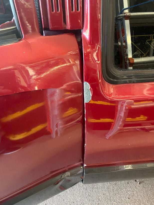

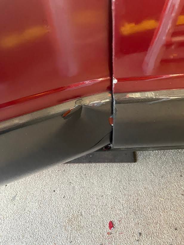

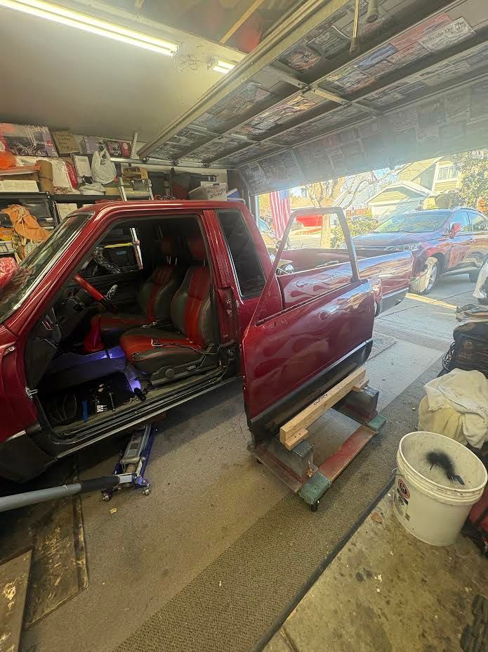

My winter work was completed, updated the stereo head unit, reworked some dash wires, changed the air compressors wires & changed from inline fuses to breakers.

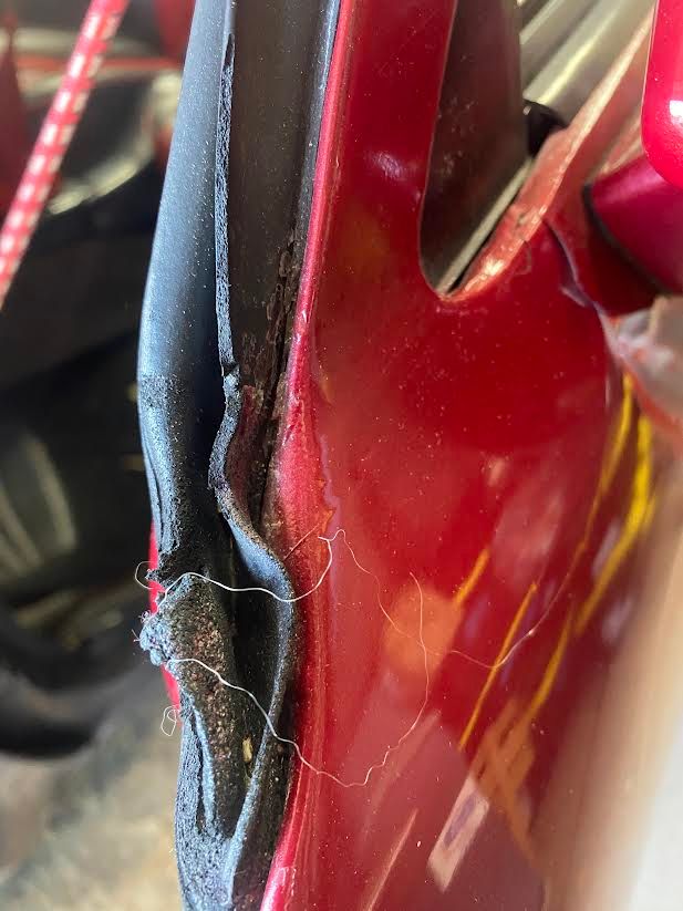

Got all back together the night before my right hand surgery . Had to move the truck out for a 2nd time as forgot to get the ice machine needed for my hand & in the rush I damaged the drivers door badly, sprung it!
My doors are stock hing & stock latch suicided !I have over 40 hours in each door. I hope to save the door ,but just in case I found a stock door with my friend Ricky's help .
If I have to replace it ,it will be a lot of work using the end places that I already have changed on my door!

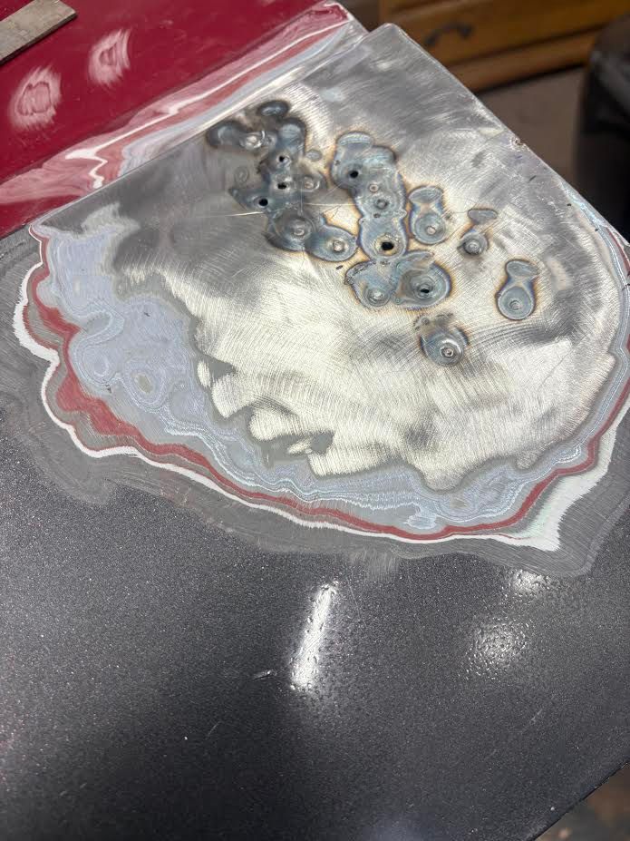

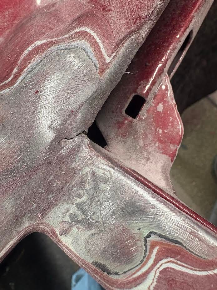

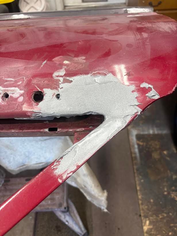

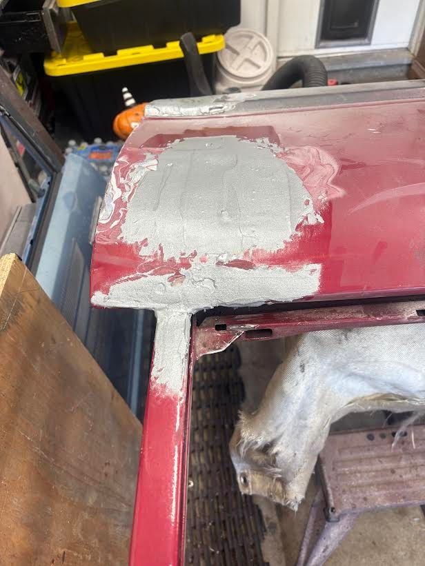

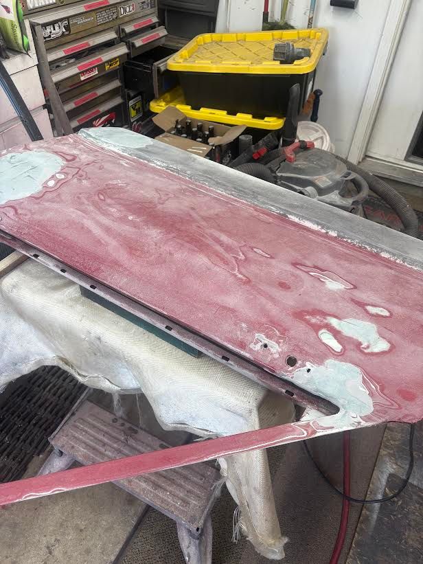

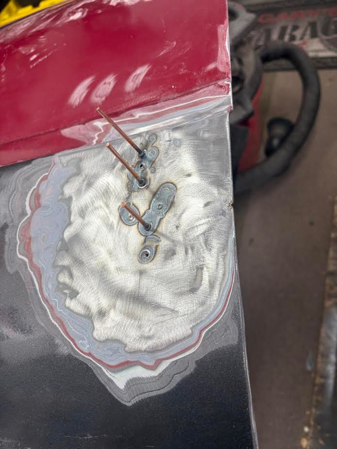

Made some forward process , made a cradle to make it easier to remove & install the door & started on the dent repair which is coming out . Two cracks one at each side of the window post. A little welding & all will be good.

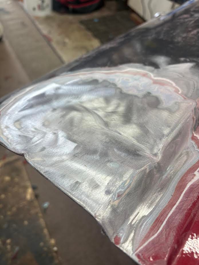

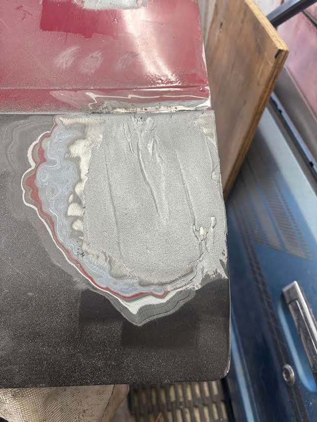

Started with the body filler, all I use is Ever Coat . First Metal 2 Metal, than Short Strand Kitty Hair, followed by Light Weight Filler

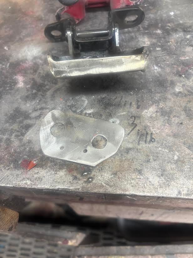

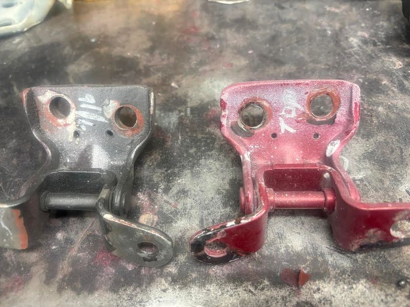

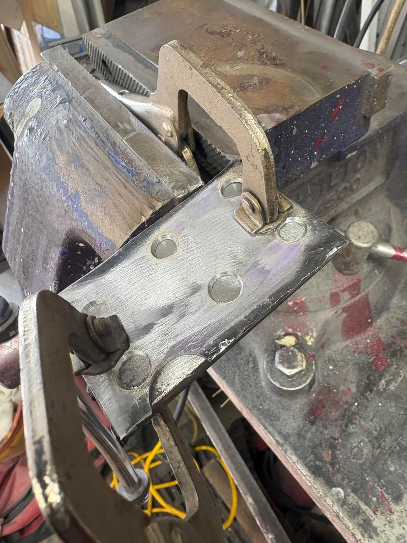

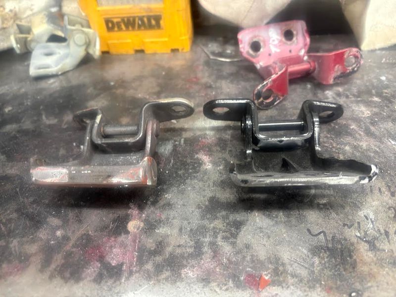

Along with the door repair is hinge replacement as may have been damaged. And I forgot the bottom hinges at the body mount end had to be made thicker to space the door outward more. Also I had drilled 2 small 1/8'' holes once the doors were swinging correctly to locate the correct position while locking down tight by inserting 1/8'' rod.
So I had to make a plate to drill those holes & a plate to weld to another plate to get the 5/16 '' thickness at welds to the hinge.
