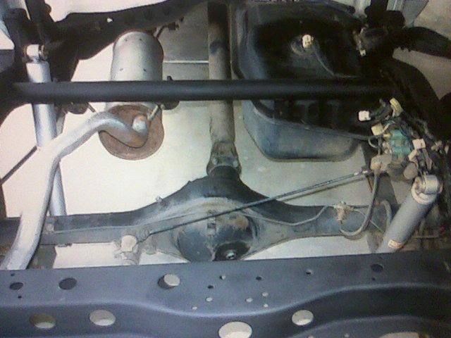

Ok, i've done some more work on the toy.
It's all most ready except for the drive side tension nuts on the torsion bar threaded set shaft are seized together and i cant break them free.
I got the passenger side broken free but the other one is impassable.
Anyways i fig. i'll at the worst i'll get a nut splitter and cut off the top nut and buy a new one.
well here's some updated pics of the progress.
The carb works great and the over all performance of the truck is good!!!!!
://i218.photobucket.com/albums/cc24/ratrod_s10/TOYOTA/020709_093100.://i218.photobucket.com/albums/cc24/ratrod_s10/TOYOTA/020709_155400.jpg
Lowering of the rear. total drop almost 4". There's is about 1/4" of space between the rubber stop and the rear end.
://i218.photobucket.com/albums/cc24/ratrod_s10/TOYOTA/020709_155500.://i218.photobucket.com/albums/cc24/ratrod_s10/TOYOTA/020809_172000.
layedout72
why did you pull the bed? if you want to go a little bit lower, pull your leaf pack one side at a time and take out the middle leaf. you can cut the bump stop down a bit with a angle grinder or saw-zall, to allow for the drop.
