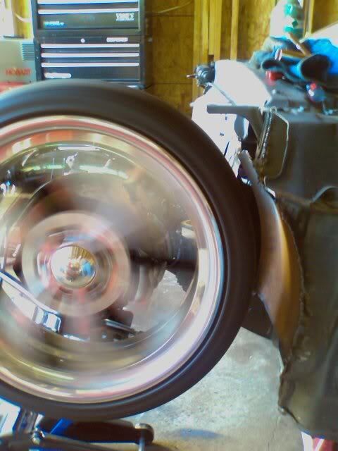

I decided to put the wheel on and take some pics from the angle it should be seen.
granth
Baha, does the bag up front fully compress or is that not the final overall tire size? To me it looks like your going to be riding on lots of pressure up front from the way the bag looks. Just making sure now, before you get much further.
We'll there's a couple things keeping it from fully compressing the upper control arm isn't on, and I'm going to be running a bigger tire like you said.
Don't worry man I've done my homework lol
