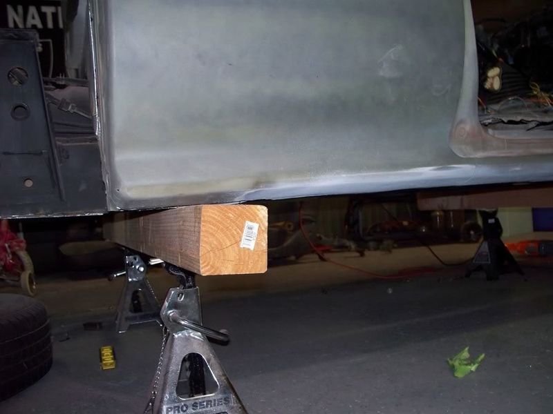

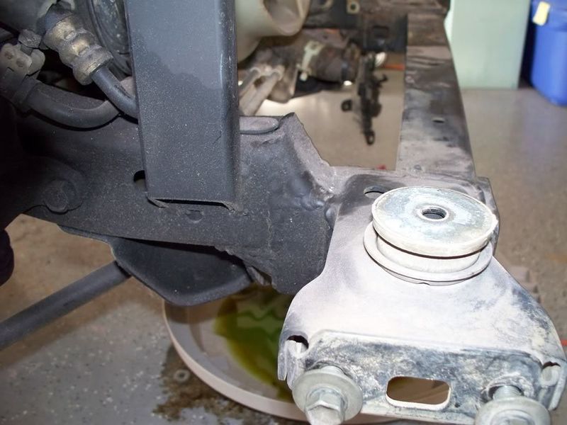

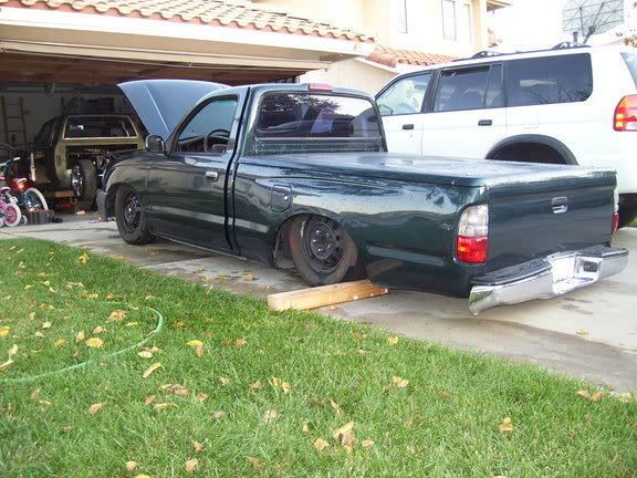

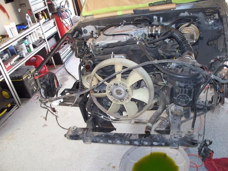

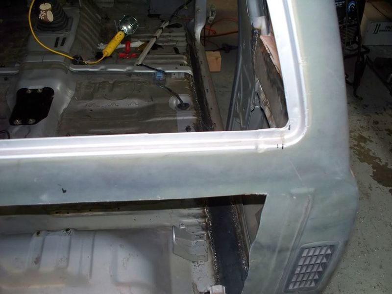

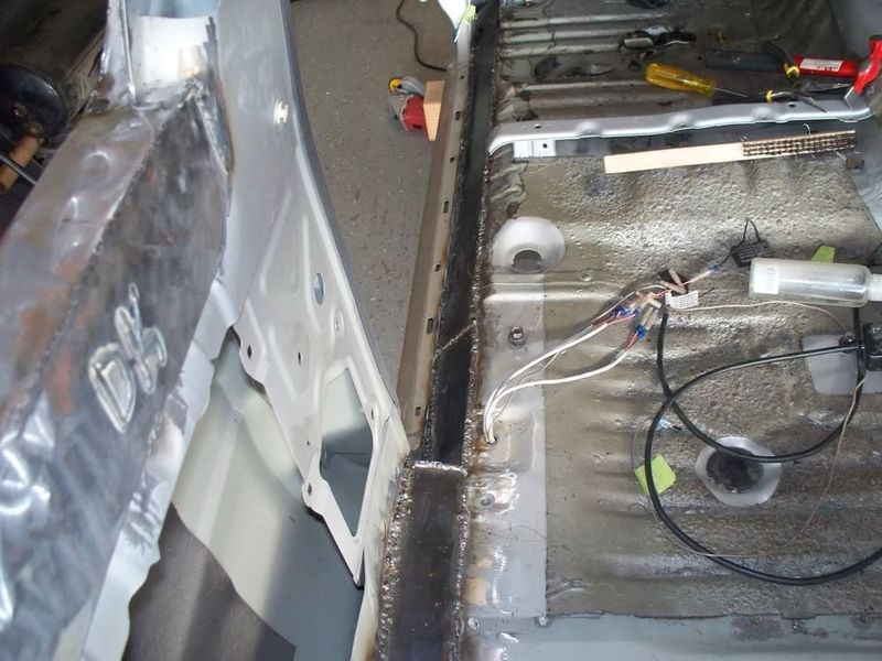

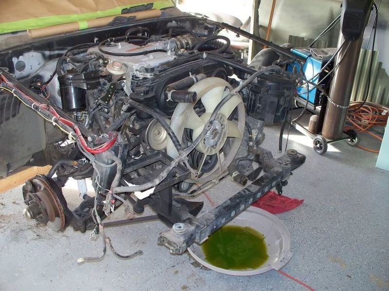

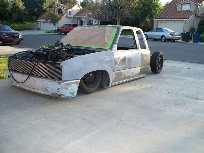

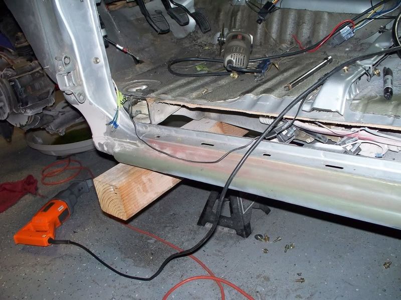

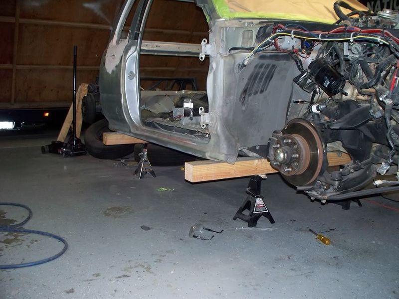

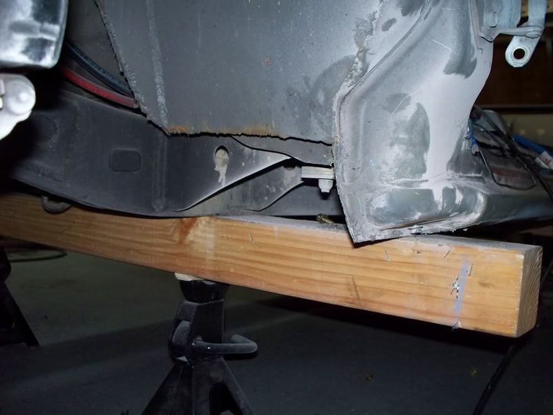

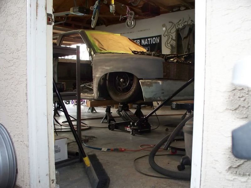

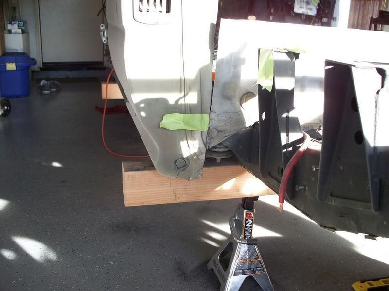

Alright, so I got a lot of pictures to upload here. The truck has been sitting on stands for months, but the bodydrop has finally started, so here you go.....

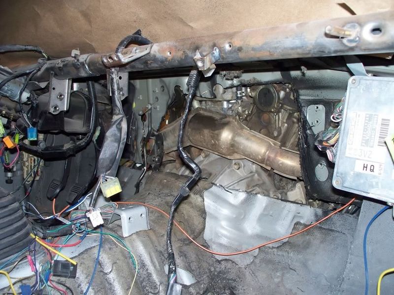

Core support removed
The engine was raised an inch from GOEZ....here's the result...I know....

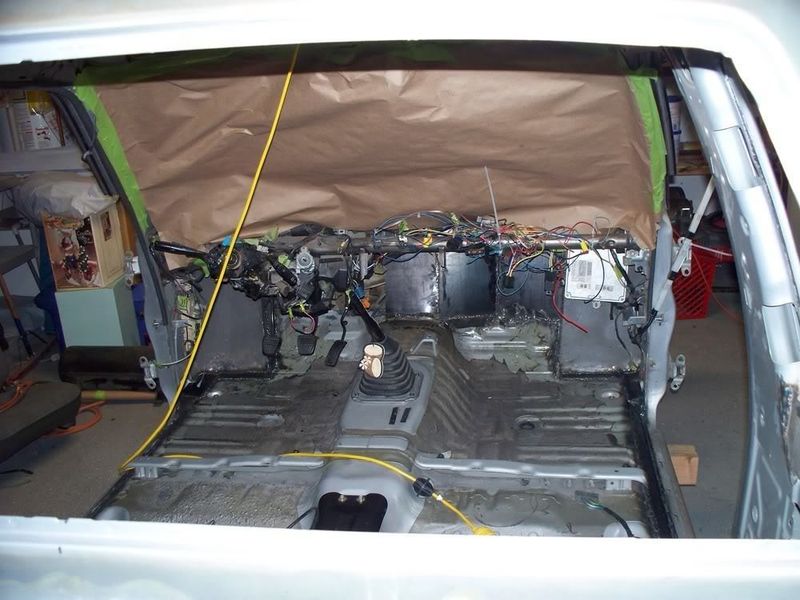

Back went down first

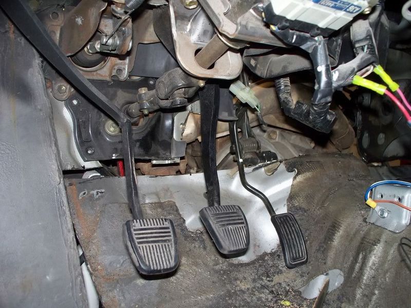

Gonna put in a new wall not so close to the exhaust
Gas pedal is not bolted in, that's why it's so low

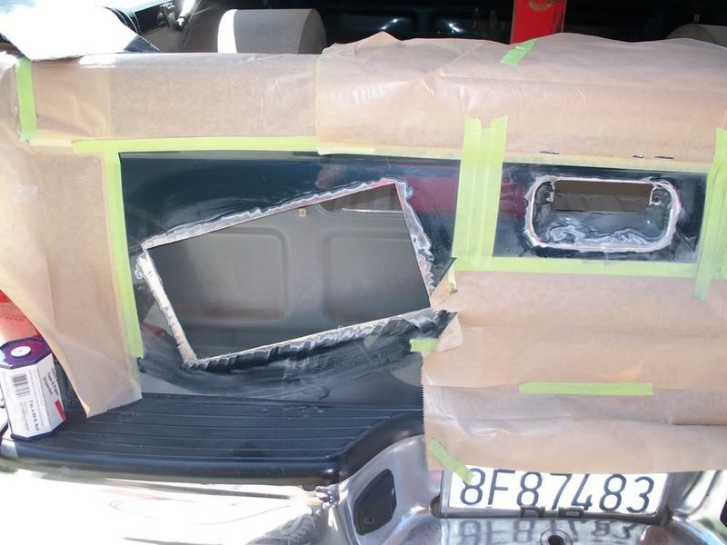

Welding it back up

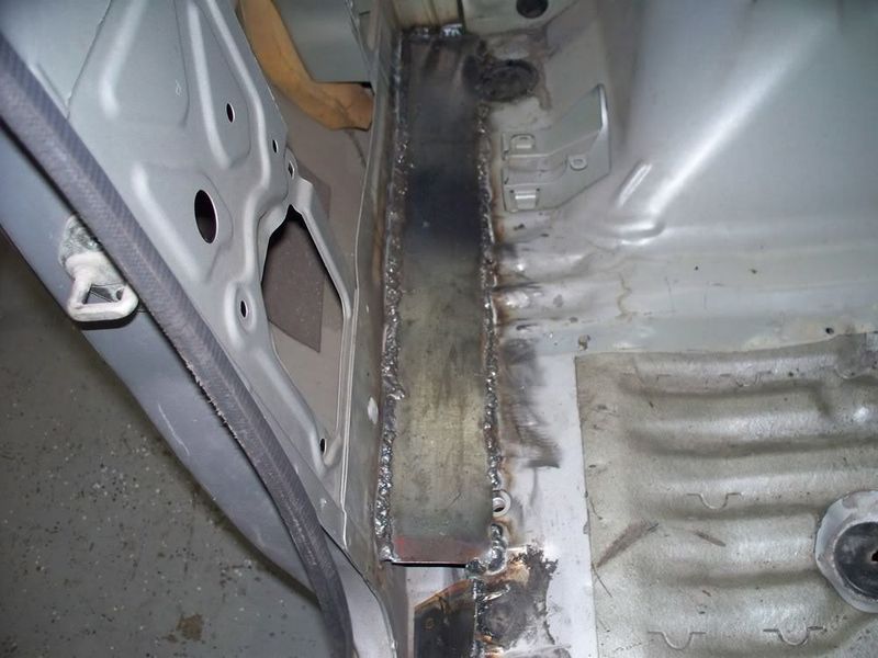

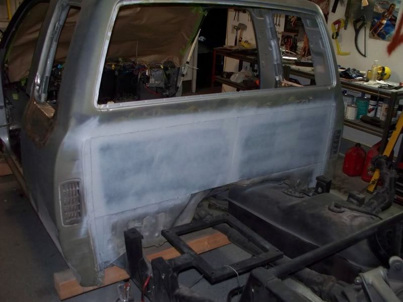

I'll be back on it tomorrow, gonna do the driver side and then move onto the smooth back wall. I'll be back!!

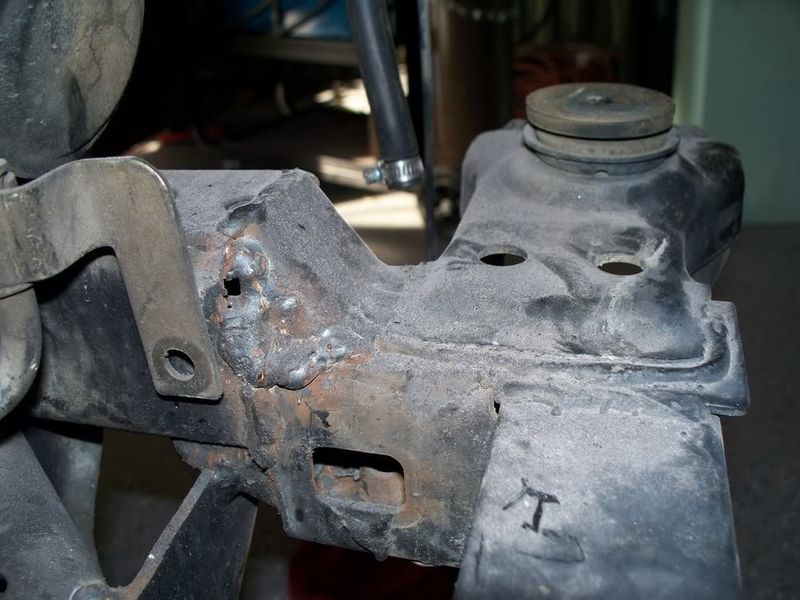

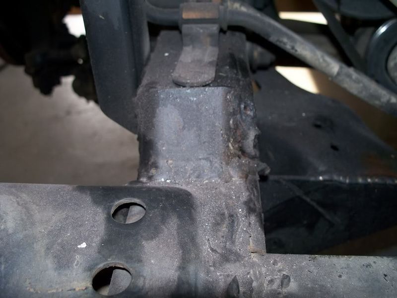

86pup

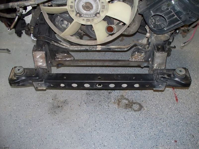

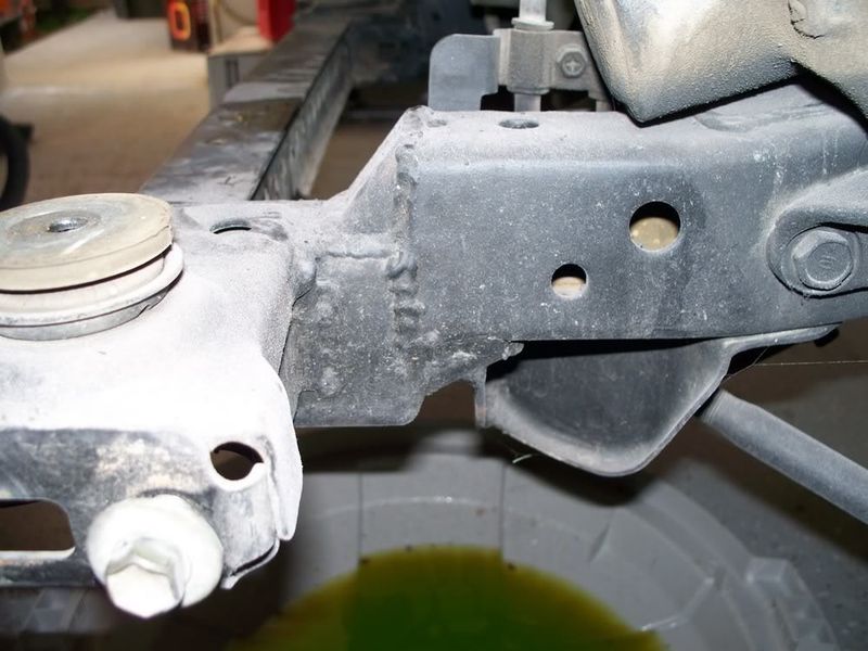

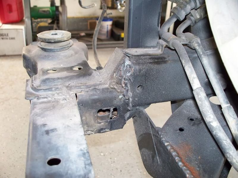

Damn that welding looks like ass
8
86pup
the welds on the frame
stll2hi's avatar
stll2hi

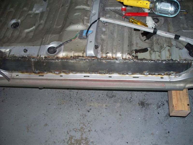

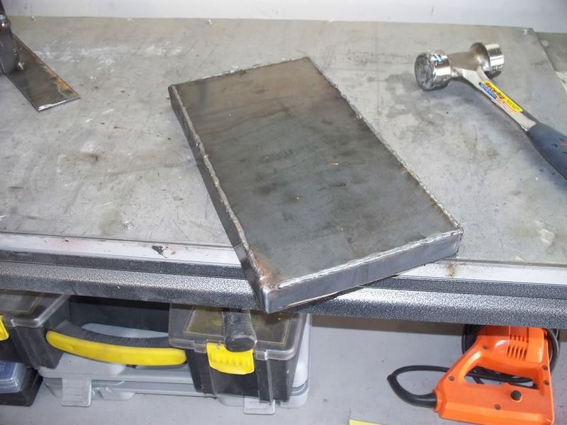

Yea, and I P A I D for that shit!!!! The outsides are decent, if you were looking with the whole core support on, but the insides are ridiculous. They had my truck for 3 months to bag the front, and this is the result. Not too pleased.

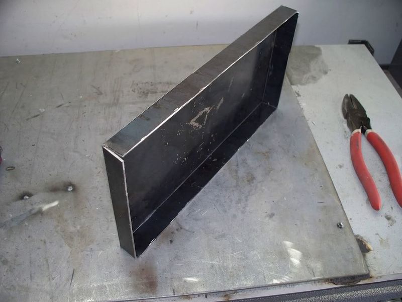

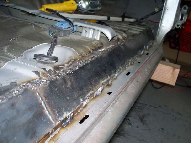

Welding 16 ga to the body for the filler plates is no fun task either. Hard to make those look good, but they're strong and will obviously be covered anyway.

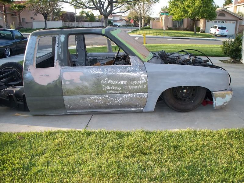

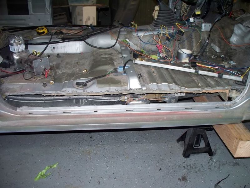

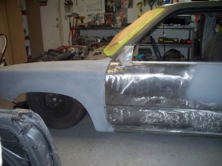

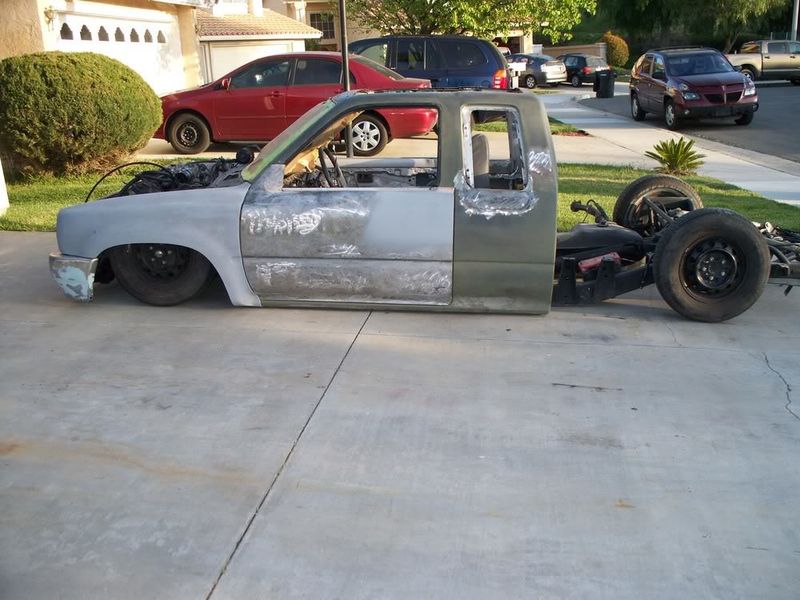

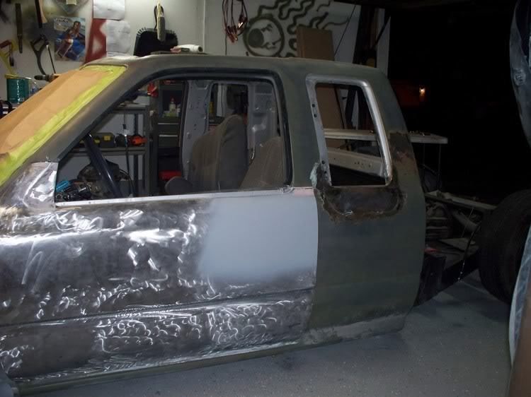

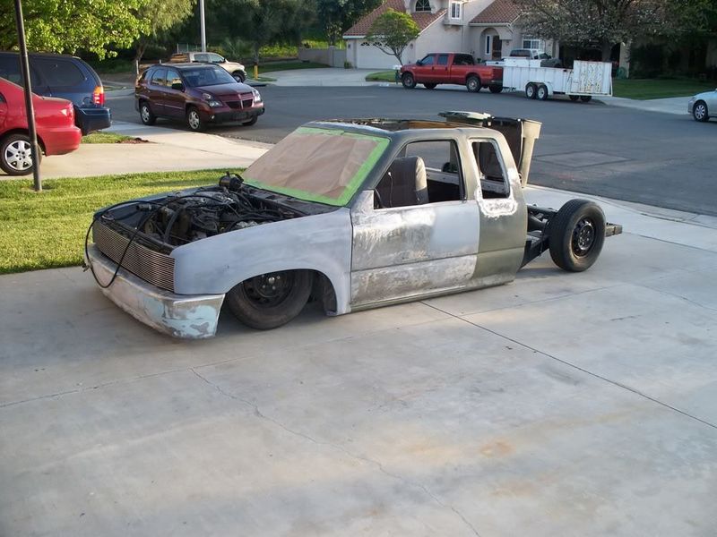

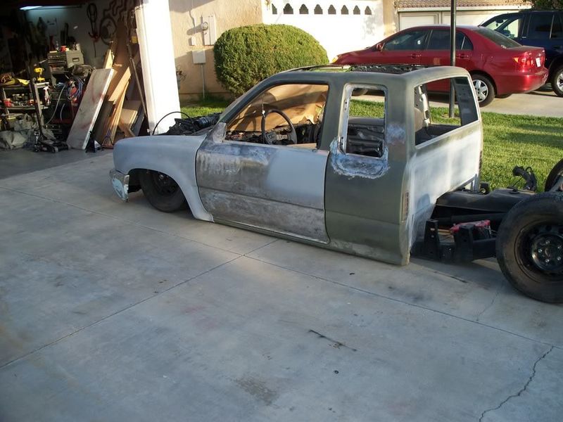

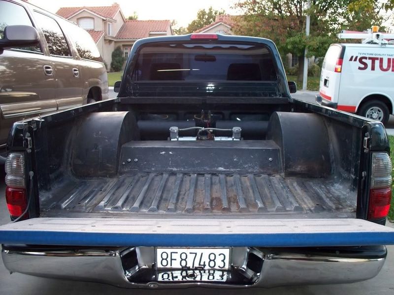

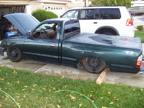

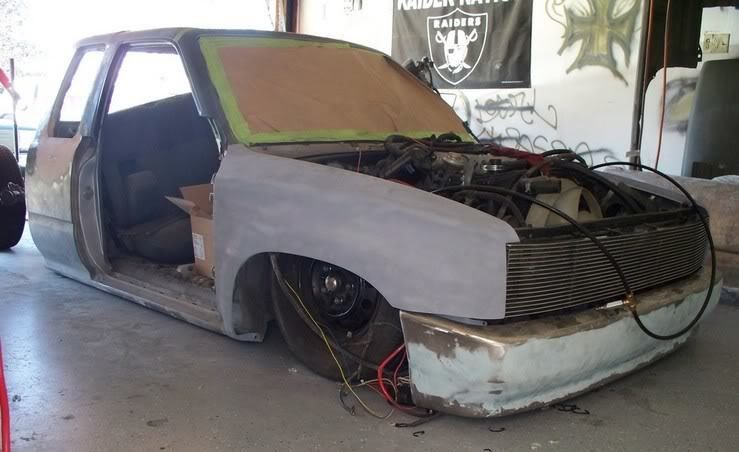

So I'm making some progress. I've been on vacation for a while and been attacking this beeotch...
Now I'm waiting on parts from suicide doors like fittings, line, etc. In the meantime, I continue....

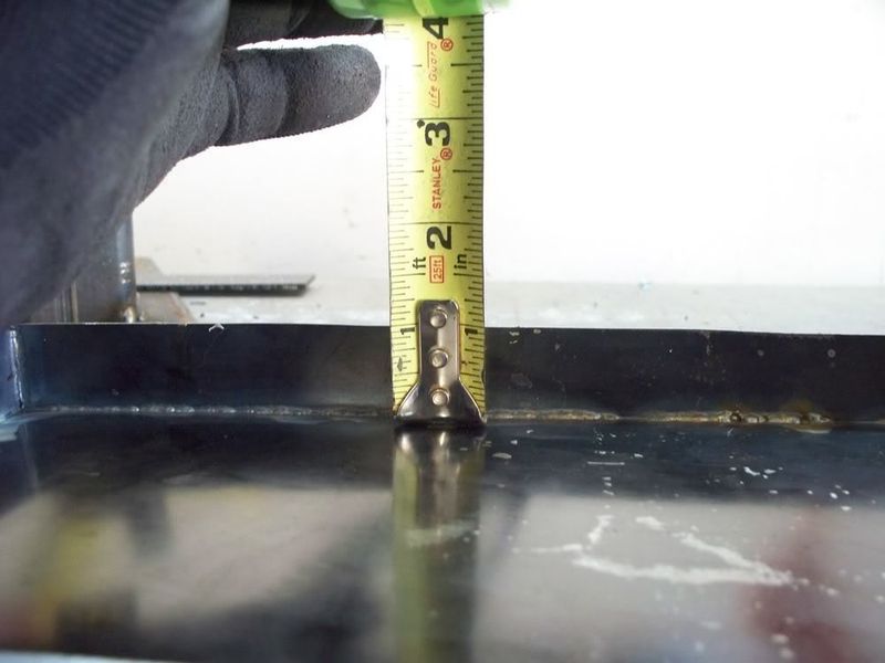

I like your work better! nice progress man, how much was your Z?
stll2hi's avatar
stll2hi
Thanks man. Turned out to be 3.5"....2.5" for the body drop, plus the 1" GOEZ had moved up the engine. They did it in a "not so good" place which made for the dramatic drop. I would have felt better if it had been back a little further, but that's the fun part of fixing things!! Engine gonna be sticking out a bit for a while!!

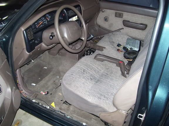

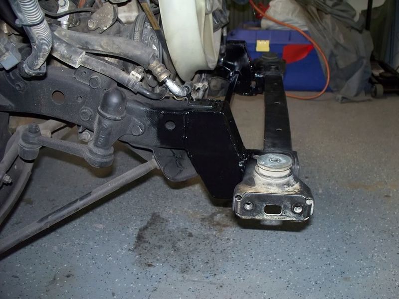

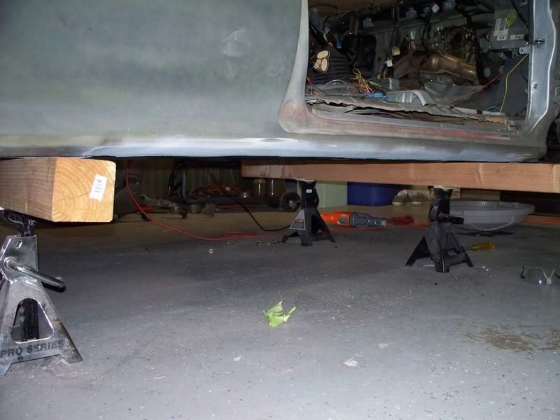

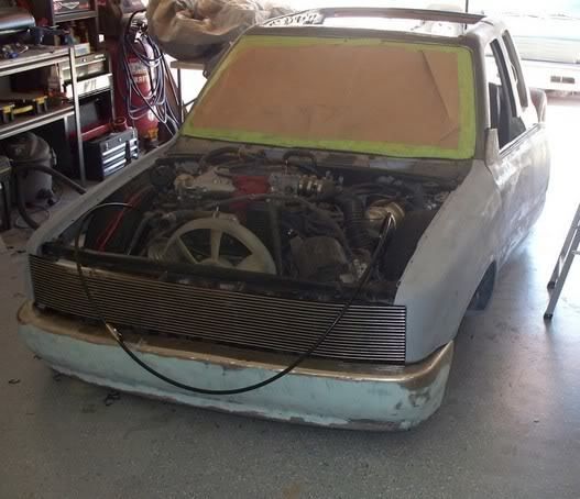

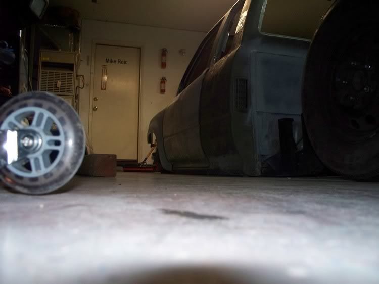

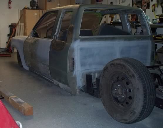

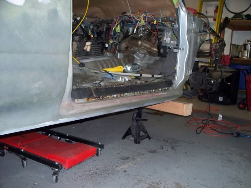

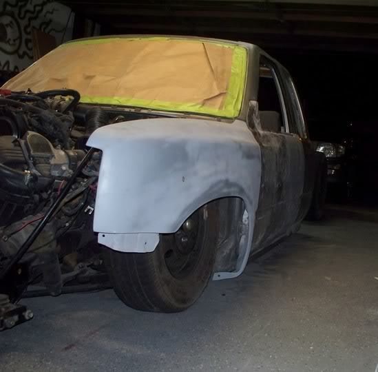

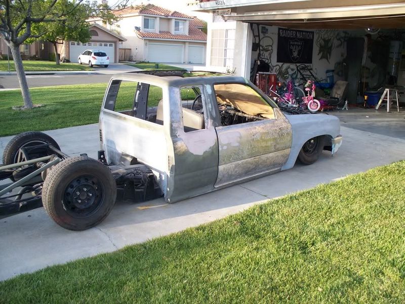

So I finally got this beotch off the jacks and onto the floor. Here's some pieces test fitted...
Next is moving wires out of the engine bay that don't need to be there, running battery cables, etc.

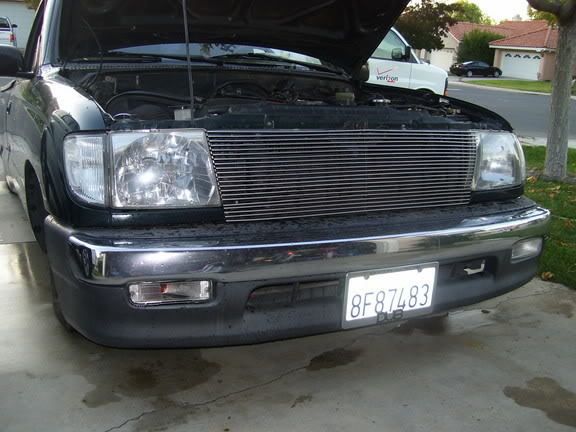

chopedmazda
im in love with the front end... def jealous of your truck
stll2hi's avatar
stll2hi

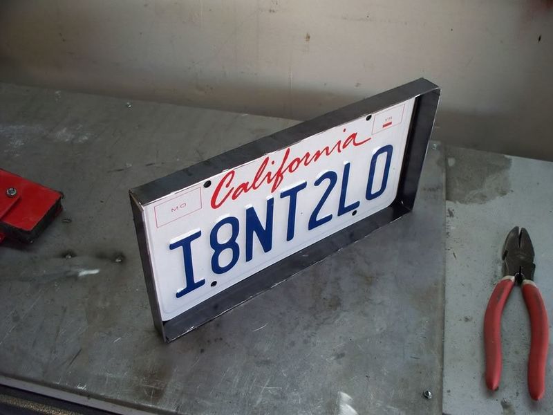

Haha...thanks. I wanted the smooth bumper, but Grant wanted my first born to make one, so I figured I'd do it myself!!
