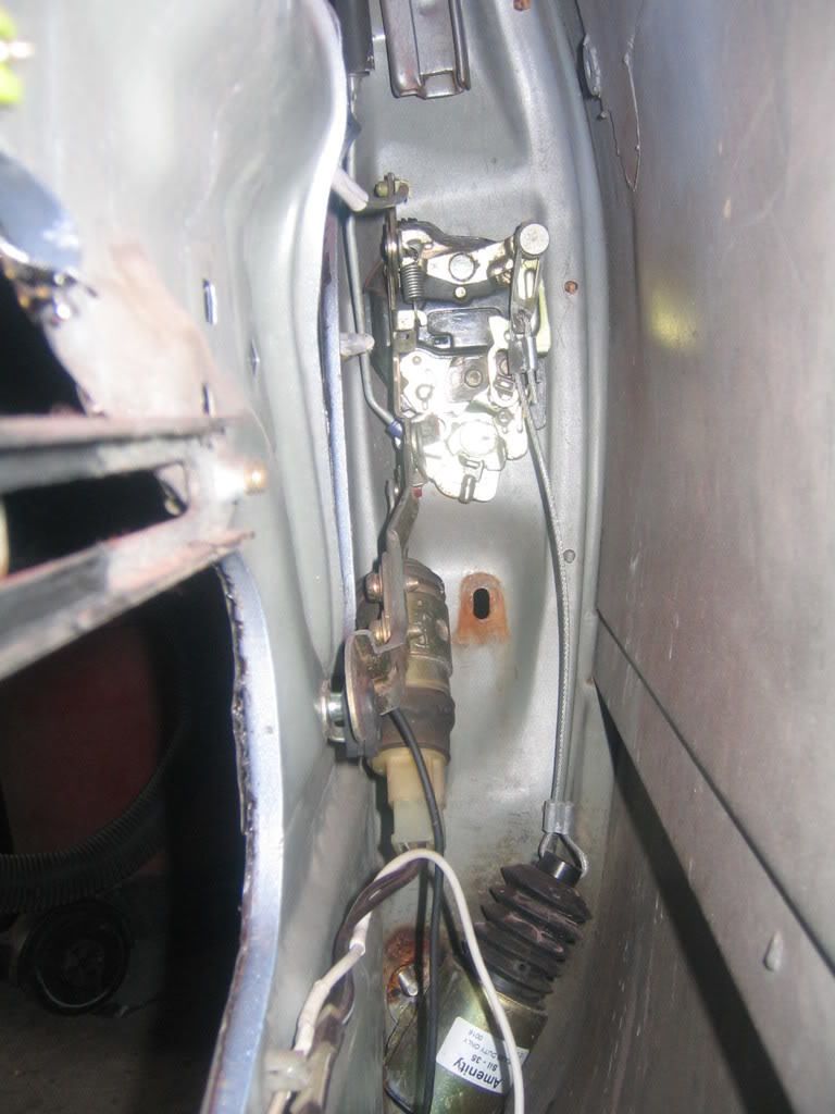

also looks as though our doors are a bit different. my track i want to say comes down a bit more, and i also have a mounting bracket that comes down to that hole just above the body line....could be wrong about the track though.
truck action's avatar
truck action
The solenoid is mounted right into the flat area before the curve! I welded the nuts to the bracket for ease of installing & used stainless button heads.
My doors are from a same year 4 Runner,but should be the same ,except one piece glass( no vent), & power mirrors,locks & windows!
The solenoids do sit @ a little angle to get the holes on to the flat of the metal.

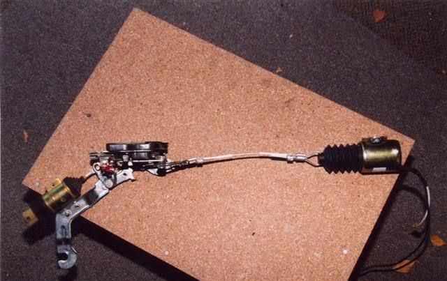

Here's the cable set up
truck action
You can get two screws into the lower corner,weld 1/4x20 nuts onto the soleniod bracket,wrap it with a wet rag @ use air to not over heat!

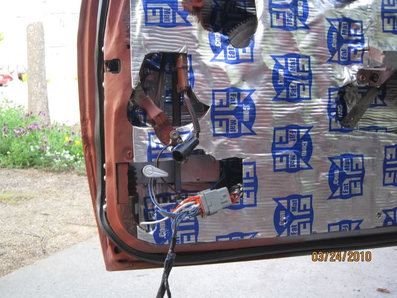

Here is a photo of the new set up ( at the other side),as the doors are now suicided
You can see the screw to the out side of the door rubber,the other to behind it.
Now added a safety latch also because of the suicide doors.
Hope this is of some help
