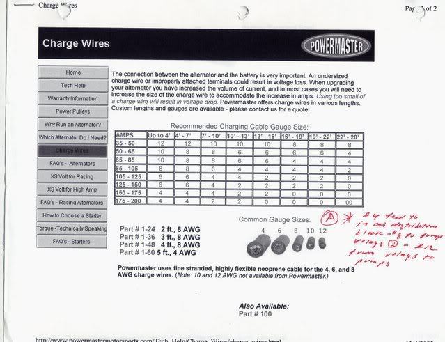

I relocated my battery to the bed area and now I'm gonna have to run a new power wire. 2 gauge...4 gauge...what do you guys recommend??
lilheed
i would run atleast 4gauge. but 2 gauge aint gonna hurt nothin
truck action
My battery is in the cab,& I run 2ga for power & ground! Will carry more apms. a greater distance!
framescr8pintoy
i did that years back and i ran 0 gauge (aut gauge).
truck action
Yes ,bigger is better!
stll2hi
That's what I was lookin' for. Thank you gentlemen!!
