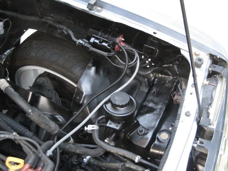

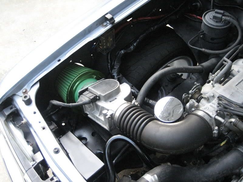

Cutting inner fenders out and needing to move my MAF Sensor and my power steering pump from the driver side fender, any pics? and do they make a smaller MAF?

Here are a few of what I did on my 91...
Ok...as you can see I did a simple relocation. I relocated the battery to the bed so it made plenty of room for the intake & fuse box-under the hood. The MAF sensor harness is long as hell & you can see in my pic that I just ran the harness from the drivers side to the passenger side under the front radiator support. As for the power steering pump I just bolted it to the inner fenderwell & ran the hoses to clear everything. If you have any more questions then ask.

hey thanks man, thats a clean setup! thanks for getting back to me

not the greatest pics but we ran the wiring down the driver side of the framerail and built the intake to go over to that side. i didn ttake these pics of the relocation but they may help u.
