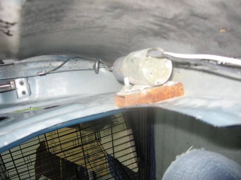

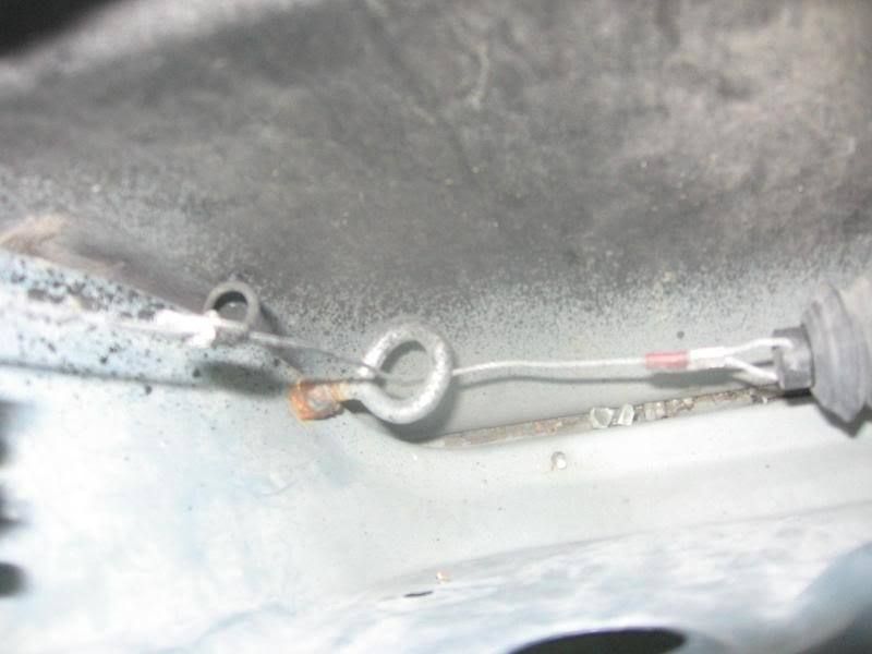

Here's how I set up mine,you will need to prefit all & loop the cable where it has a little slack!

I welded nuts to the solenoid bracket to make mounting easier. Make sure to keep the heat away from the solenoid whaile doing this!
truck action's avatar
truck action
I mounted the solenoid at the bottom front of the of the door @ a angle facing upwards. Used stainless button head screws !

I used the stock metal tab that is on the latch,just reshape & drill a hole! I also removed the power lock.
This is on a 88 Toy,with 4 Runner doors,as have power windows.
Hope this is some help!

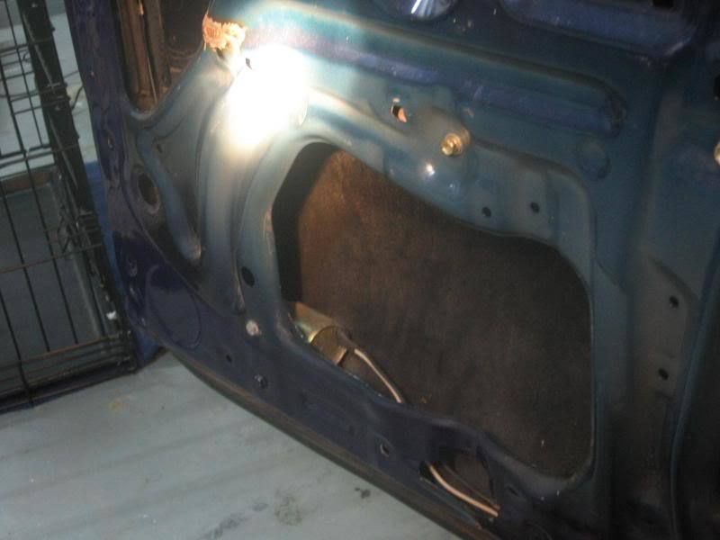

slammedtoys's avatar
slammedtoys
here is mine in my 94... simular to truck actions
truck action
I don't think your set up is simular to mine. You have a smaller cable( looks ilke a bicycle cable) & it'ds pulling to the side. Should have pull stright !
