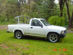

hey guys whats up? im new from oregon and i had a question
where can i get just a basic lowering kit for my 94 yota?
vegasyota94's avatar
vegasyota94
do the torsions in the front, and then goto like autozone or something and get the drop blocks for the rear.. you can also remove some of your leaf springs.. all but one.. or just remove one on each side.

is there some place i could take it like les schwab or some place like that?

its not a bad height now but i want it a lil lower

I can take some pics for you if you would like.. Its pretty easy.. You should be able to pick up blocks for bout $30 online.. Think i got mine from God Fathers and it had the 2 degree angle on it... the bars in the front are easy as well. Total cost if your doing bars and blocks is like $30 to get her on the ground
