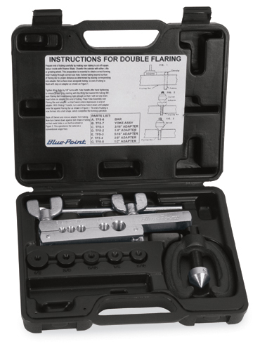

you'll need 3/16 tube nuts for your lines.
NAPA part number 105x3
you'll have to cut off the flares and 10mm nuts, put on the 3/16 and re-double-flare the tubing.
you do realize you still need a t if you use one of those valves right?
9
92yota
yea, i am going to tee the two lines first, then into the valve. i have no idea what re-double flaring is. i've actually never done anything with brake line before. do i need certain tools to do this stuff with? or should i have someone else do it?
kdcgrohl's avatar
kdcgrohl
double flaring tool.
